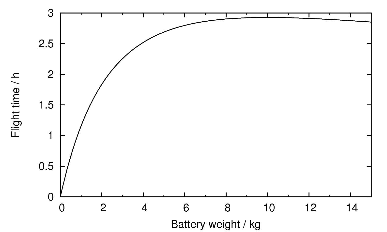

For the CF, the thrust/weight ratio is more a matter of preference, depending on how much flight time you're willing to sacrifice for maneuverability. For heavy payload, camera/fpv applications, flight time is more important than maneuverability. For these applications, you may only need enough thrust to keep the CF hovering, with some ability to climb occasionally. The next logical question becomes "how big of a battery should I load the CF with before the weight of the battery counteracts the extra thrust that it provides?" The answer to this question is in this study on Optimal Battery Capacity. Here's a summary of the study: Maximum flight time is achieved when battery weighs twice as much as the weight of the copter without batteries. Beyond that, any more battery capacity is cancelled out by its added weight. That said, inefficiency of the motors and battery energy/weight density won't allow us to fly a 13 gram CF with a 26 gram battery-- A 4-motor CF can only carry about 10-15 grams of battery weight. But the principle does still hold true up to a theoretical 26 gram battery: Despite the weight increase, a bigger battery will allow the CF to fly for longer.

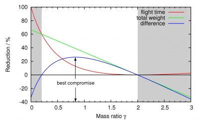

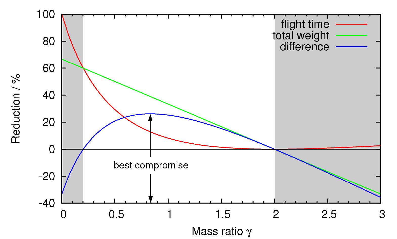

But a CF loaded with a heavy battery does impact maneuverability. The study also shows there is a point of optimum compromise between weight and thrust (maneuverability): "The best compromise is for batteries that weigh about 83% of the airframe. For this mass fraction, about 87% of the most optimal flight time is still achieved and this with only 61% of the total weight." Thus for a 13 gram CF, the most efficient compromise between flight time and maneuverability is ~11 grams of total battery weight (83% X 13 grams).

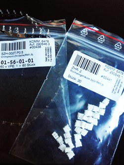

If the new battery's connector won't allow you to disconnect and pull out the metal leads, you'll have to just cut the wires and create new metal leads and feed them into the connector from your CF battery or use a new CF battery connector. You can purchase new JST-ZHR-2P battery connectors from segor.de that will fit into the CF battery port. You'll have to send them an email with the number/type of connectors you want (don't forget to order 2 metal wire clamps for each 1 connector so you can clamp them around the ends of the wire before inserting them into the plastic connector).
2013-06-29 10.09.06.jpg (112.46 KiB) Viewed 12485 times
Offer to pay with PayPal and they'll send you an email back with the total cost in EUROs and their PayPal address. When you issue a PayPal payment, there's an option to send the payment IN EUROs. CAUTION: If you send any amount in US dollars, they'll refuse your payment, minus processing fees. Also the people at Segor are very polite, but they're German, so write your email as plainly as possible. Mine came in the mail just fine.

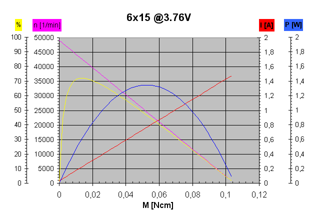

The motor performance as well as the propeller performance is very important. The picture shows the 6x15 motor characteristics graph @3,76V. It is only based on a theoretical model and is therefore not fully accurate but shouldn't be to far from the reality. The graph looks different at every operating voltage so this one is only somewhat true @3.76V.
Operating between the maximum efficiency and the maximum power point is a good rule of thumb.
Some measurements I have taken indicate that the motors with the current propellers are about 50% - 55% efficient when hovering. Each motor then consume about 330mA and operates at ~2.5V.
Adding more weight, in form of a bigger battery, quickly decreases the efficiency so a 50% increase in battery capacity might only increase the flight time with maybe 25%-30%.

Here's a graphic that illustrates Tobias' point about the diminishing returns from adding battery capacity.
This is why it's important to find the best compromise between adding battery weight and sacrificing maneuverability (83% rule).
