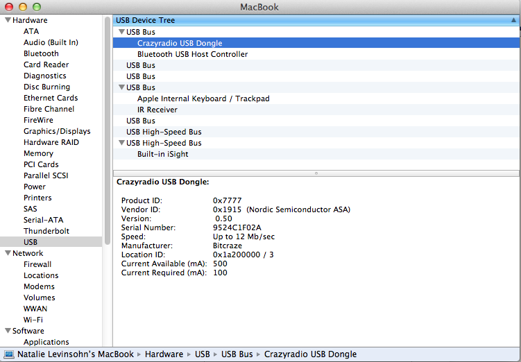

I'm running OSX 10.7.5. Actually I just looked in System Information and it does show up.
Then I boot up the cfclient and its still not in the list? Any ideas?
