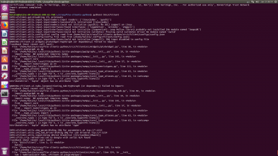

I followed the instructions to install the client in linux. But when trying to start it. It shows as :Image
I searched several questions on github. But still didn't work.
I installed the PySDL2-0.9.5 and it still shows no such support.
My cf-lib-python is new since I installed it yesterday and the linux system was updated just now. Does anyone knows how to fix it?
Thanks.

There seems to be a problem with the dependencies. Have you installed the client by typing "pip3 install -e ." from within the project folder? More generally could you describe the step you did to install the client?
What linux distribution and version are you using?

arnaud wrote: ↑Fri Feb 01, 2019 5:57 pm There seems to be a problem with the dependencies. Have you installed the client by typing "pip3 install -e ." from within the project folder? More generally could you describe the step you did to install the client?
I fork and clone the crazyflie-client-python to the computer. And followed the instructions on the readme file.
First installed the
sudo apt-get install python3 python3-pip python3-pyqt5 python3-pyqt5.qtsvg
Then in the source file, that is crazyflie-clients-python:
pip3 install -e .
Then
python3 bin/cfclient
in the same file. Then the pic I posted showed.

I typed exactly the same commands in a fresh Ubuntu 16.04.5 VM and it works well without any error. This could come from a python package installed by another program.
It seems to come from numpy so one thing to try is to uninstall and reinstall nympy with "pip3 uninstall numpy" and "pip3 install numpy"

Thanks for your reply. I tied to uninstall numpy and reinstall. But it still reports the exact same error.
