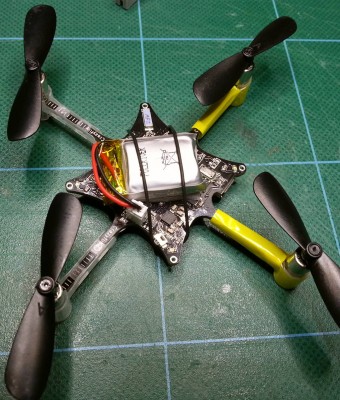

I haven't had time to do any software mods, but thought I'd share my removable battery mod. An o-ring and piece of soft, tacky foam does the trick. This particular o-ring is 27x1.0 mm.
I also recommend cutting off the teeth on the battery connector case.

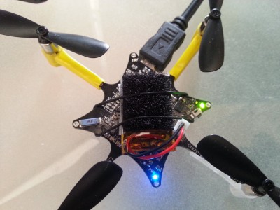

I'm using Velcro right now. All the solutions with an adhesive scare me a bit in that in principle they might wrench off a component when removed. I like the OP's idea a lot!

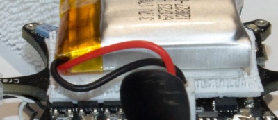

I use velcro as well but I don't think it sticks good enough due to the battery not being flat. I think I'll try to get the items for this and try it out. Any idea on where one can go about to find foamy stuff?

I'd try just regular foam tape, tape one side to the battery and leave the other unsticky/covered.

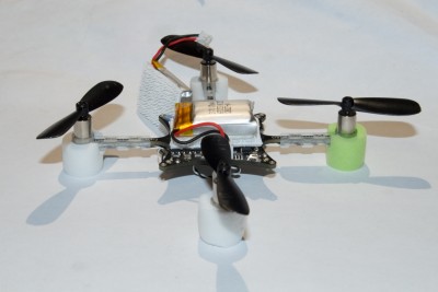

Btw, I'm using velcro plus foam tape, plushy side of the velcro is taped to the foam tape, foam tape is taped to the Crazyflie, hook side of the velcro is taped to the battery. Works ok-ish, I have to hold the plushy side done when exchanging the battery though, the velcro sticks together better that the foam tape and the Crazyflie.

Hmm I see. I have no problem with the velcro not sticking to the board but the whole battery rig is a bit wobbly because the area of contact is too small/the plush is too long. I have the velcro hooks on the flie and the plushy side on the battery.

I tried velcro too at first, but all the issues already pointed out are what I experienced. It's not the way to go IMHO. Although some plush velcro on the upside of the lipo as pictured below aint a bad idea. I think it helps the o-ring grip the cell.
Try find a foam wholesaler in your area, and ask for some scraps. It's a bit more effort, but I think it'll be better than two-sided adhesive foam because the adhesive guards are usually slippery plastic or wax paper. The right foam will be soft and tacky at the same time, and you can still glue it to the board with some contact adhesive or two-sided adhesive film tape.

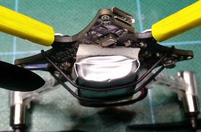

I happened to have some 3M Command Picture Hanging Strips from some other stuff I was doing and they worked well for my battery. It holds a lot firmer than velcro (medium size can hold ~9lbs, though they are 2x the length of the battery). Just cut one in half and remove the pull tab. Doesn't even wiggle!
