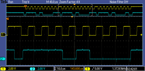

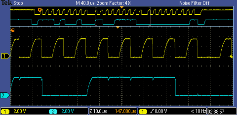

Here is the images of the ocsilloscope.
When my I2C sensor connecting to crazyflie:
When my I2C sensor connecting to the arduino:
Duncan
