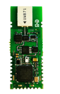

I understood the Power Amplifier part but I am still not sure of what hardware you are using, so to be clear: if you are using a DWM1000 module that is different than this one: https://www.decawave.com/products/dwm1000-module the antenna delay in Two Way Ranging mode needs to be re-calibrated.
As long as you are using similar UWB radio in all your system (ie. if all the antenna delay are very similar), you should not need any antenna delay calibration for TDoA: when calculating the time difference of arrival the antenna delay gets canceled.

The antenna is the same, namely the antenna and DWM1000 chip added a PA, as shown in the figure.In that case, the antenna delay need not be changed, where to change with TDOA mode?Timestamp?

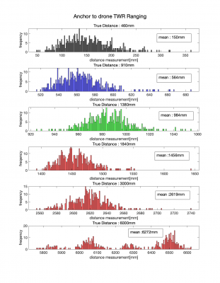

I just tested a TWR ranging accuracy between one node and one crazyflie.
The ranging data was from LoPoTab0 - ranging.distance0.
The data showed ranging error of over 300mm.
Is this also a problem of antenna delay?
If it is, is there some kind of criterion which value should I fit in? or should i just find the value experimentally?
