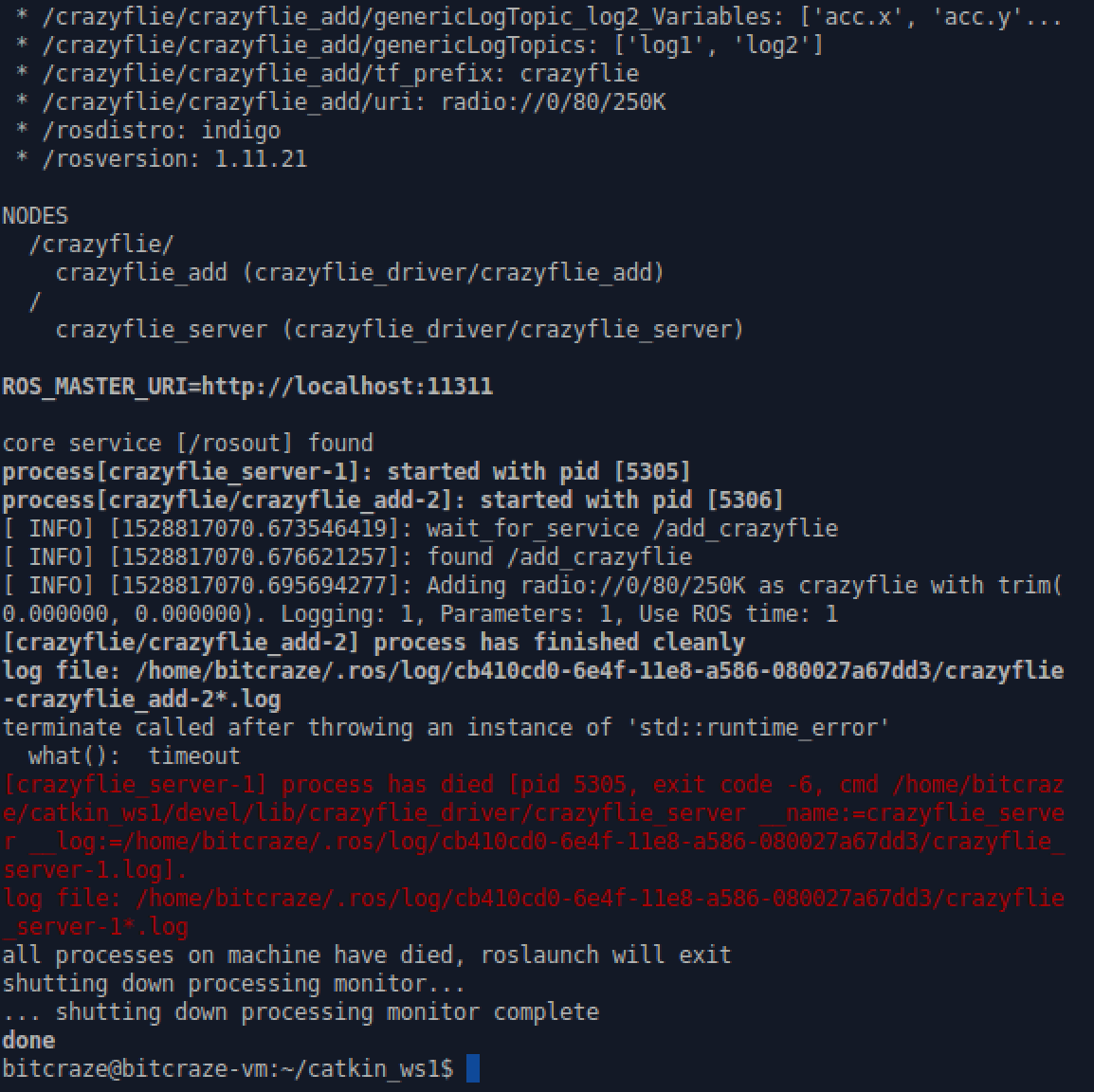

Good morning, I'm using the ROS stack for Bitcraze Crazyflie, with ROS Indigo and Ubuntu 14.04.
I would like to display the imu sensors with the command:
rostopic echo /crazyflie/imu
The crazyflie server appears in the rosnode list, but if I run any example I have a what() : timeout error:
roslaunch crazyflie_demo customLogBlocks.launch uri:=radio://0/80/250K
and this is the output:

That usually means that it couldn't successfully connect. Please double check your uri, also by running
rosrun crazyflie_tools scan

whoenig wrote: ↑Wed Jun 13, 2018 7:11 pm That usually means that it couldn't successfully connect. Please double check your uri, also by running
Thak you for your answer, I found out that the uri of the file did not corresponded to the uri of the crazyflie, so I modified the launch file with gedit.
And now it works!!!! :D
