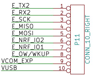

I think I found a discrepancy in the Rev.C schematic and the expansion pinout above.
I think the UART2 Rx/TX lines are marked incorrectly in the expansion board.

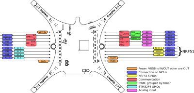

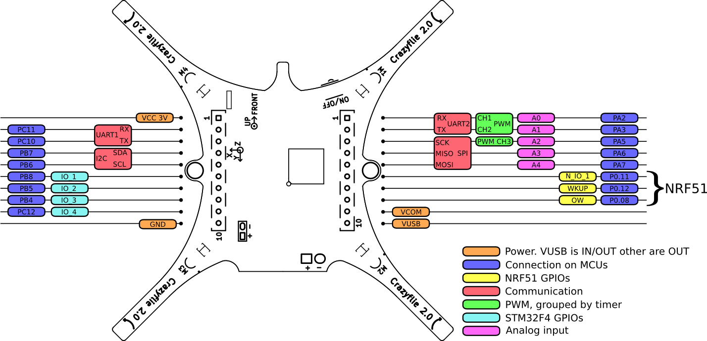

Expansion Board as currently posted:
Expansion Right as shown in Rev.C schematic:

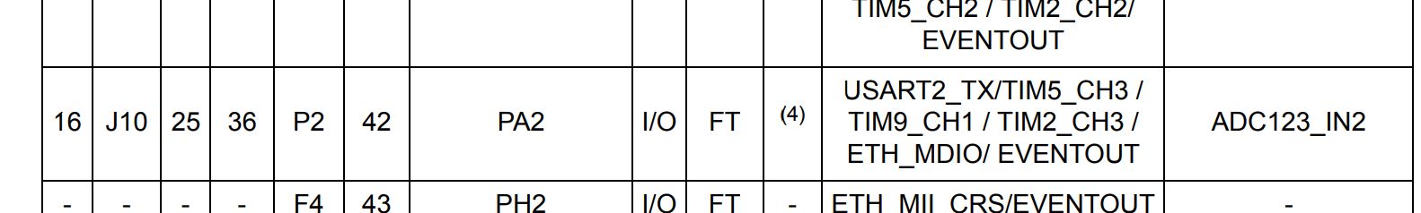

E_TX2 goes to Pin 16 of the STM32F405 which is PA2 = USART2_TX according to the datasheet:

For UART1/UART2 those are logical names and where not necessary planned to have the exact STM32 name and calling it USART would be misleading since the extra S is there for Synchronous mode which is not supported by the deck (afaik the clock pin is not cable to the deck port). The logical name is
used by the deck drivers
Though I can confirm that UART2 RX and TX are reversed in your picture but they are correct in the wiki: https://wiki.bitcraze.io/projects:crazy ... ards:index. Where did you find this diagram?
For N_IO_1/N_IO_2 this is a bug. We should update the diagram.
