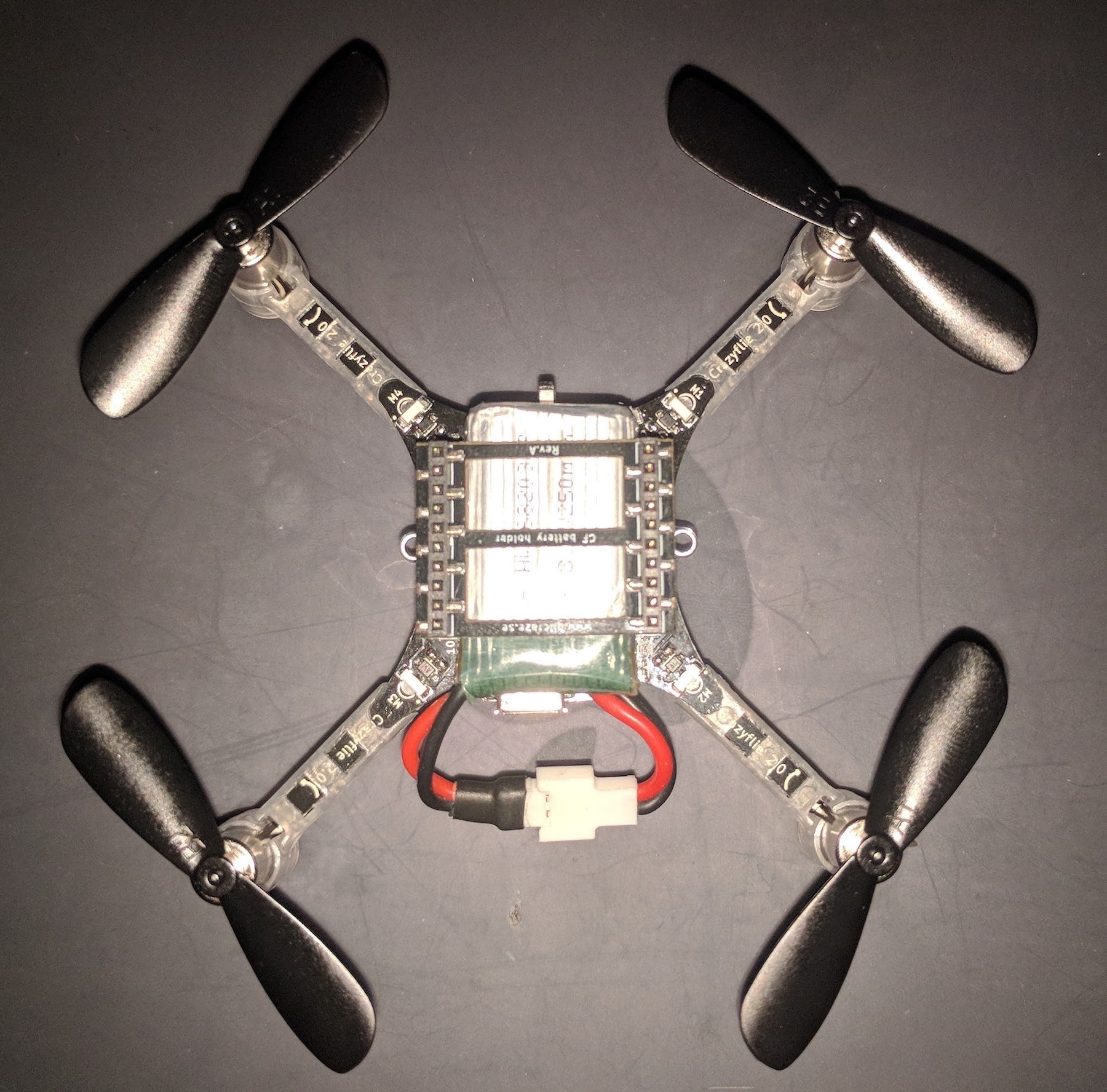

Can you take a photo of the CF assembled as you think it should be? Then it will be easier to troubleshoot for any potential errors.

Attached is the image of the setup that I think is how this section of the instructions says it should be: https://www.bitcraze.io/getting-started ... infostep20
However, that setup doesn't make it fly...

That looks exactly right, and like my setup, except i don't have the new markings on the propellers.

I agree that the setup looks rigth. Are the propeller turning on the direction of the arrow draw on the Crazyflies 'arm' ?

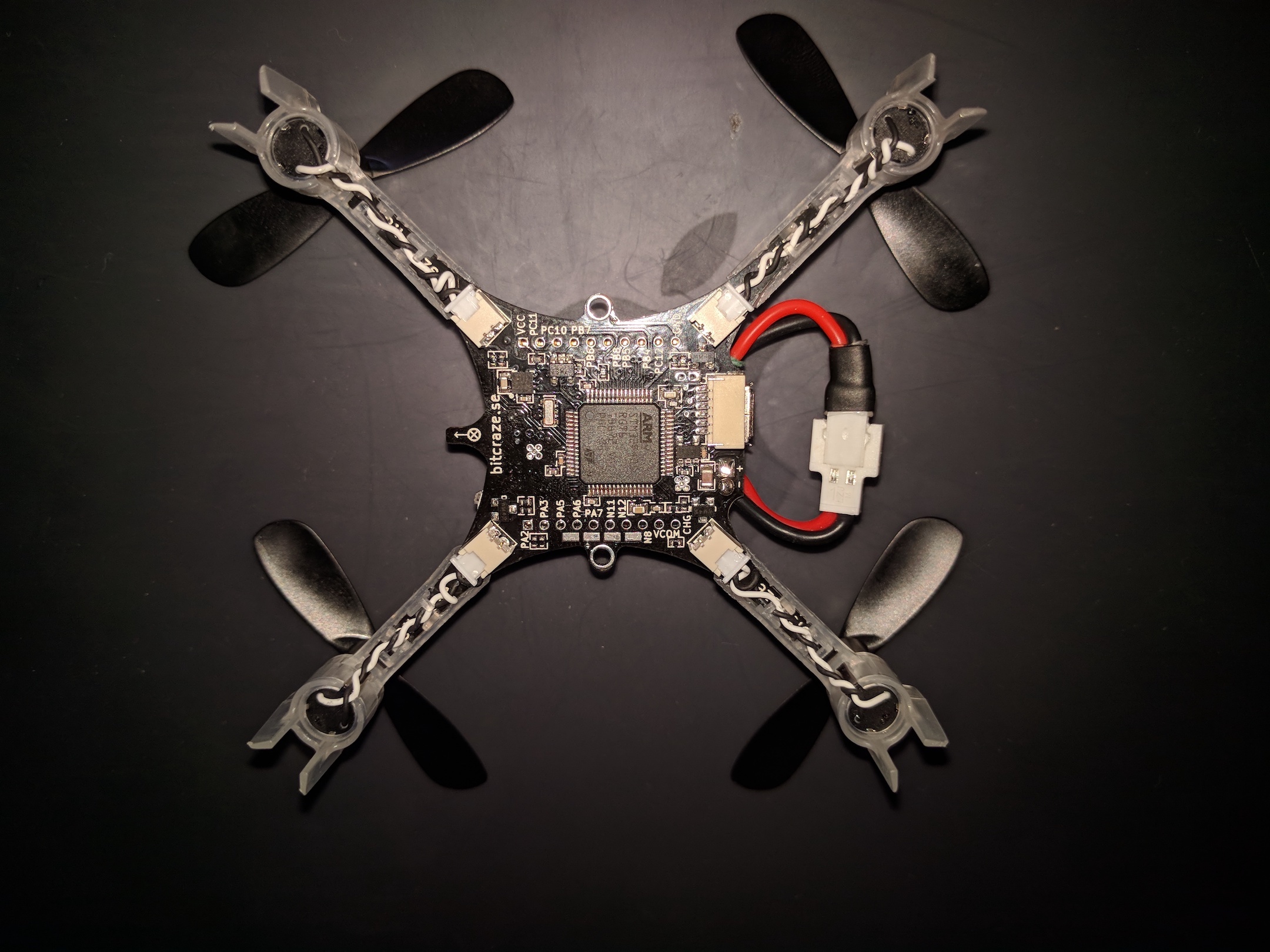

This is a bit worrying... In the rare cases only one of the motors has been spinning in the wrong direction. Can you please take a picture of the backside so we can see the motor connectors.
The quickest fix to this is to switch the pluggs in the motor connectors. Using something small and sharp, like a needle, the "stopper" can be lifted up and the pluggs pulled out.

Attached is the backside of my Crazyflie 2.0 as how it is supposed to be assembled. I ordered my product on the 2nd of March of 2018 with order #2031 through this site: https://store.bitcraze.io/collections/b ... 3833397013
