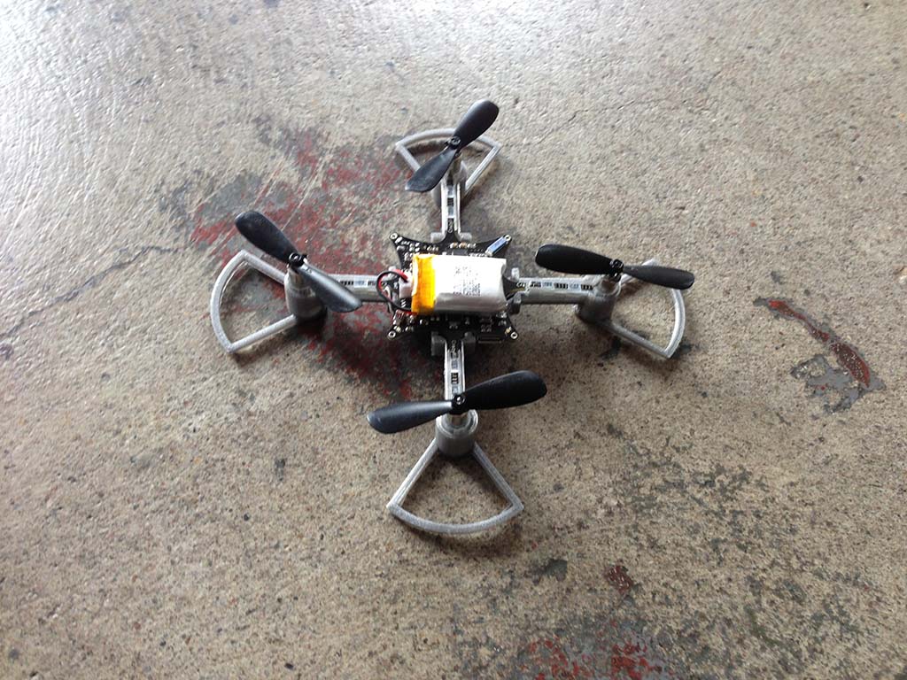

On the second flight of the Crazyflie one of the arms snapped off.
I created a 3D model that reinforces the current arms and allows a snug enough fit for broken arms to be supported as well.
Currently the design is a little on the heavy side, or I have my settings wrong, so it does affect flight performance, but at least I got the little guy flying.
Here is the STL:
http://www.thingiverse.com/thing:95216
Petr
Snap of the fixed Crazyflie

Great work! I added it to the list of 3d printed addons on the wiki.
With how much infill did you print this frame? Maybe you can play with perimeter count and infill to lower the weight a bit. If I see this correctly in the model the motor mounts have closed buttons? Careful with that, that will lead to the motors not having a place to go when hit on the propeller side (e.g. during an impact flipped upside down) and might lead to impacted axle syndrome. Have you though about designing it more like a bumper kind of frame around the edges of the board you just snap on so you don't need that much material?
