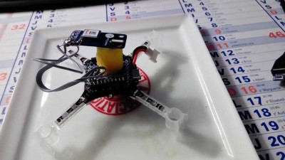

I had much difficulty when trying to get a fix with my Ublox MAX M8 GNSS. The problem was only a bad soldering of the ground. Now, I get a fix in 1 minute when lucky and at most 2 minutes...
The receiver installed on a crazyflie:

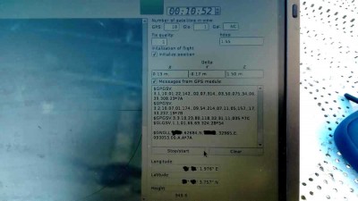

and a new GNSS tab in the client.
