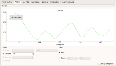

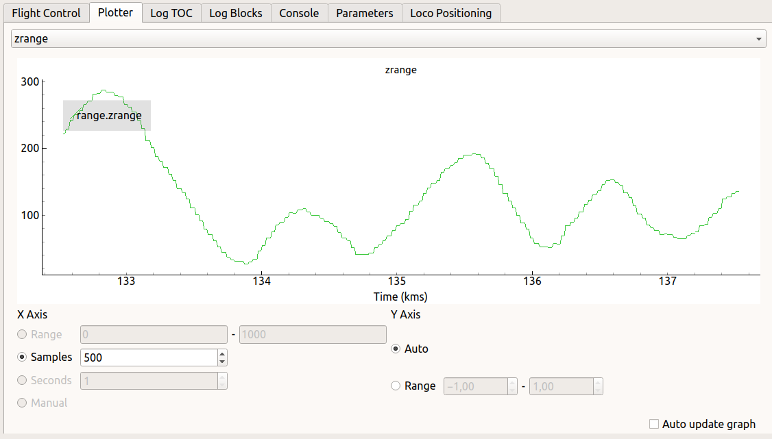

Re: Flow Deck issues
That might be something, maybe there is a problem with the VL53L0 distance sensor. Can you create a log block and plot the range.zrange value with the flow deck connected.One other thing when I connect it to the client on my mac the actual height value is always 0.00
