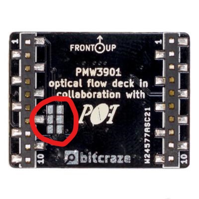

Operationally, I have a question - the Flow deck uses the LeftExpansion7 (IO_2) pin and so does the LED Deck for the serial data for the WS2812B LEDs (labelled on the schematic as PWM_DOWN). How does that pin overloading work?
Images for reference...
Flow Deck:
LED Ring Deck:

Nevermind.... I just saw that IO_2 is NOT used on the flow deck :P
Even though the schematic shows R4, R5 and R6 connected to IO_2, they are not populated on the boards.
Maybe update the schematic to reflect this?
Re: Flow and LED deck combined?
Posted: Mon Oct 08, 2018 10:10 am
by arnaud
The resistors to IO_2 are marked "NM" which means Not Mounted. I guess we can add some textual explanation on future schematic to mark clearly that these are intended to be not populated out of the box.
