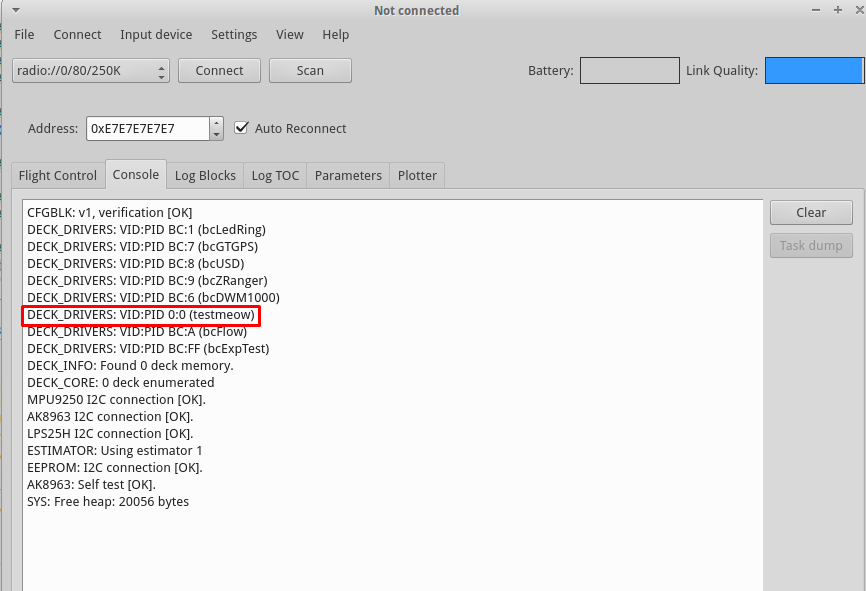

I have been trying to create custom deck on my Crazyflie 2.0 that will for now set pin IO1 to high. I have tried following these tutorials:
https://wiki.bitcraze.io/doc:crazyflie: ... deck:howto
https://wiki.bitcraze.io/doc:crazyflie: ... ration_api
But I cant seem to get even the most basic deck working. The drivers shows up in console upon connecting to the crazyflie python client but the initialization function and test function don't print to console like in the tutorial.
Below is my deck code:

My crazyflie firmware did not have a config.mk so I made a new file called config.mk and below is what I put in it. I have also tried with DEBUG=1 but that did not help.
CFlAGS += -DDECK_FORCE=testmeow
I then run Make CLOUD followed by FLash using radio
So have I done anything wrong? Any pointers would be much appreciated :D

Re: Trouble with creating a custom deck
Would be great to know more about your custom deck :-)
I think the problem is that the FORCING of the deck doesn't work and I think it is because you accidentally used a "l" instead of "L" in CFLAGS
Post by mrpie_ »
Oh wow... I can't believe that I missed that, I spent a fair few hours messing with this.
Thanks you so much!
