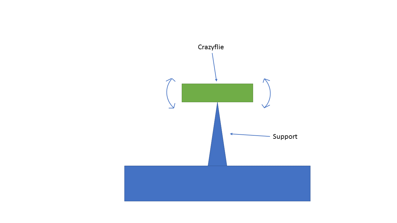

I think I may not have expressed myself very well, so here is a picture representing what I mean just so that we are on the same page:
The crazyflie is resting on the support, so the only thing I would need is just the pitch/roll PID controllers to work to keep it flat. As I said before, with the current implementation of the code there needs to be some base thrust for the PID controllers to work, and, well, there is no need for a base thrust when the cf is supported in this way. Therefore, I want to be able to make the roll/pitch PID controllers work without any base thrust.
Is this the scenario that you were giving your answer for?

Re: Activating roll/pitch PID control without setting a throttle value
Posted: Wed Jun 28, 2017 11:14 am
by arnaud
Hi, I was discussing it with Tobias so I can jump-in on that.
Yes this is the scenario for which Tobias answered.
To control the attitude, the propeller are going to have to produce force on the Crazyflie side. Being cabled to run only in one direction with a fixed propeller pitch we can only produce thrust in the up direction.
This means that the mean thrust to the platform will always be positive in the up direction: there is no way to control the Crazyflie attitude without applying at least a little bit of thrust. The mean thrust will also help controlling the yaw since this is also controlled by the propeller speed.
That said, if the mean thrust is way lower than required to lift the platform, the Crazyflie will not takeoff and you can then obtain what you seek.
There is a minimum thrust level that you might want to disable in the firmware in order to test: https://github.com/bitcraze/crazyflie-f ... rpyt.c#L37. You can try to apply as low thrust as possible (starting with 1 :-) and see how the existing pid reacts.
