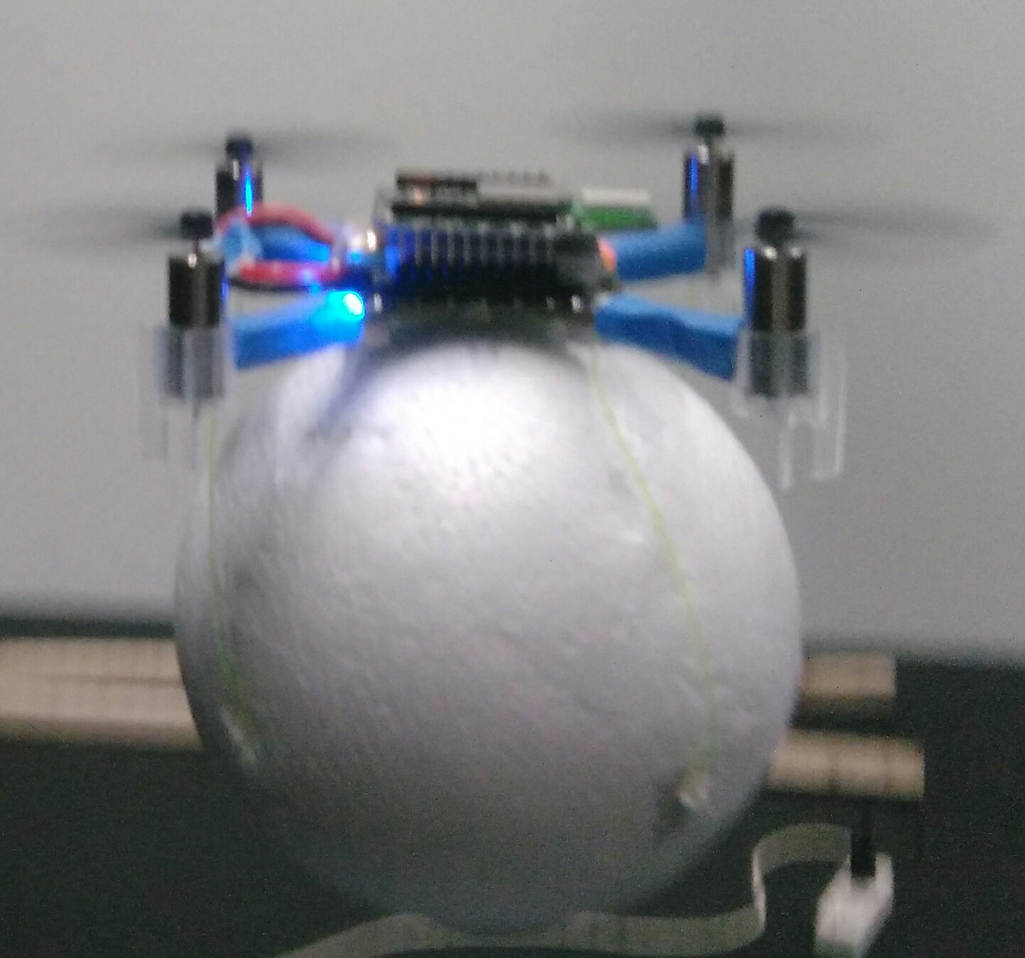

I'm currently working on a project where I'd like to have a crazyflie lifting a polystyrene ball, as shown in the picture attached (Picture taken in-flight, so the quality is bad)
As I'm using LPS, I managed to make it hover correctly (even though it oscillates more than a simple drone), and to make really simple and non-violent trajectories (go to this point), but when I try more avanced ones (i.e : Follow a point that follows a circle shape), The drone starts to oscillate dangerously, and then crashes.
It seems logical that the drone behaves differently with the ball, as it changes its weight, center of gravity, moment of inertia, etc...
My first instinct was that I have to tune the pid again to adapt to this new configuration, but as I am a beginner in the quadcopter world, I wasn't sure about it (And I never tuned any PID before).
Has anyone done something similar, is the PID my problem here, or have I missed something ?

That is a big ball for a small CF2
You could try to tune it while flying manually as a first thing. Start to focus on the PID values for the rate PID for pitch and roll. E.g. first try to just half those values and see if it improves the stability. Also try lowering the attitude PID values a bit. This you can all do live by changing the parameters in the cfclient.
