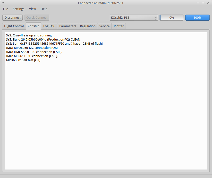

i tried flashing my crazyflie with the Firmware from this page: http://wiki.bitcraze.se/projects:crazyf ... x#firmware and this guide: http://wiki.bitcraze.se/projects:crazyf ... ie_service . But this is not working. I powered the crazyflie within 5 seconds after clicking the button "Initiate bootloader cold boot" but all that is happing can be seen on this screenshot:
. I waited untill the crazyflie powered off by itself but now its not working proper anymore. I can connect to the flie but then its not reacting to thrust commands :-(
anybody here which can help me?

hi, the operating system on my laptop is windows 7, but i am using the provided Virtual Maschine with the VMware Player.
The Crazyflie is an 6DOF one and the Connect informations can be seen in the Screenshot:
The Red LED is only lightly glowing and flashes aprox every 2 seconds.

From my point of view the Crazyflie and CrazyRadio looks fine! (the two FAILs are normal for your 6DOF).
