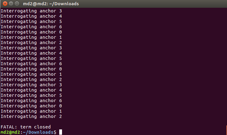

Following the instruction here:
https://wiki.bitcraze.io/projects:lps:node
I have tried picocom /dev/ttyACM0 to access to my LPS node but it loops endless with this Interrogating anchor thing. May I know how to solve it? I have attached a screenshot of it.

The node has for some reason been configured in tag mode. You can configure it back by pressing "a" followed by a number you want the anchor to have.
