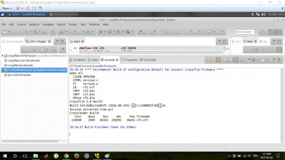

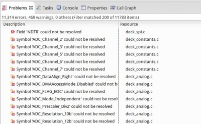

When I choose the project called crazyflie-firmware, I change de definition of the SYS_LED to LED_GREEN_R. Then, when I build the project, I get multiple errors all following the same structure (i.e. The type led_t can not be resolved). If I do a code_analysis of the entire project, I get 45 000+ errors. As shown below.

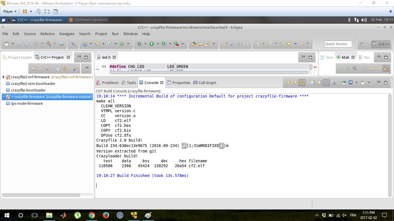

However, when I build the project, everything seems to work fine. I obtain the following result.

I don't think the code analysis has been setup. Could explain all the errors. I don't think it is that easy to setup either since we use an external makefile.

Thanks for the reply. I understand for the code analysis. But these errors still appear if I do not run a code analysis. For instance, if I decide to change a parameter in a file (the sys_led is a good example), I will have errors such as (type led_t could not resolve). But, when I build (make file), everything seems normal.
My question is , if I do make a coding mistake, lets say I set the sys_led to blah_green, will I be able to know there is a mistake, or will the error disappear in all the (could not resolve issues).

Currently, in Eclipse, the only way to know that you have made a mistake is to compile (make) the project and the compiler will tell you that you did something wrong (including what and where).
