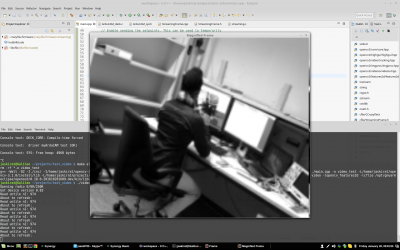

Thank you very much for you inputs. They were really useful. I was already transferring the image with the consolePrintf but it was not fast enough.
Therefore, as you suggested, I've implemented the streaming using a new CRTP port and it actually worked quite well because I'm already able to show my picture on the PC using libcflie (https://github.com/fairlight1337/libcflie) and openCV.
I will share everything as soon as I will be ready to do that (anyway by April 2017 which is my thesis deadline).
I still have some issue related to the SPI speed setting and a general slow frame rate problem.

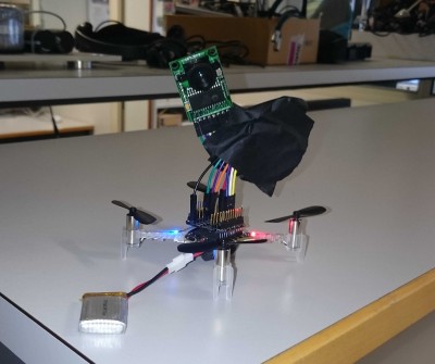

Here some pictures.
ArduCAM connected to Crazyflie
Streaming screenshot

Thanks for the pictures! The camera setup looks ... interesting :-). Does it fly?
/Arnaud
Re: [Solved] Streaming video
Posted: Mon Jan 23, 2017 8:15 am
by jassi0709
Hi Arnaud.
Hahahah no the mechanical part is not ready yet. I have to find a proper way to fix it and understand how to minimize the weight.
Will do that in few days.
Jassy
