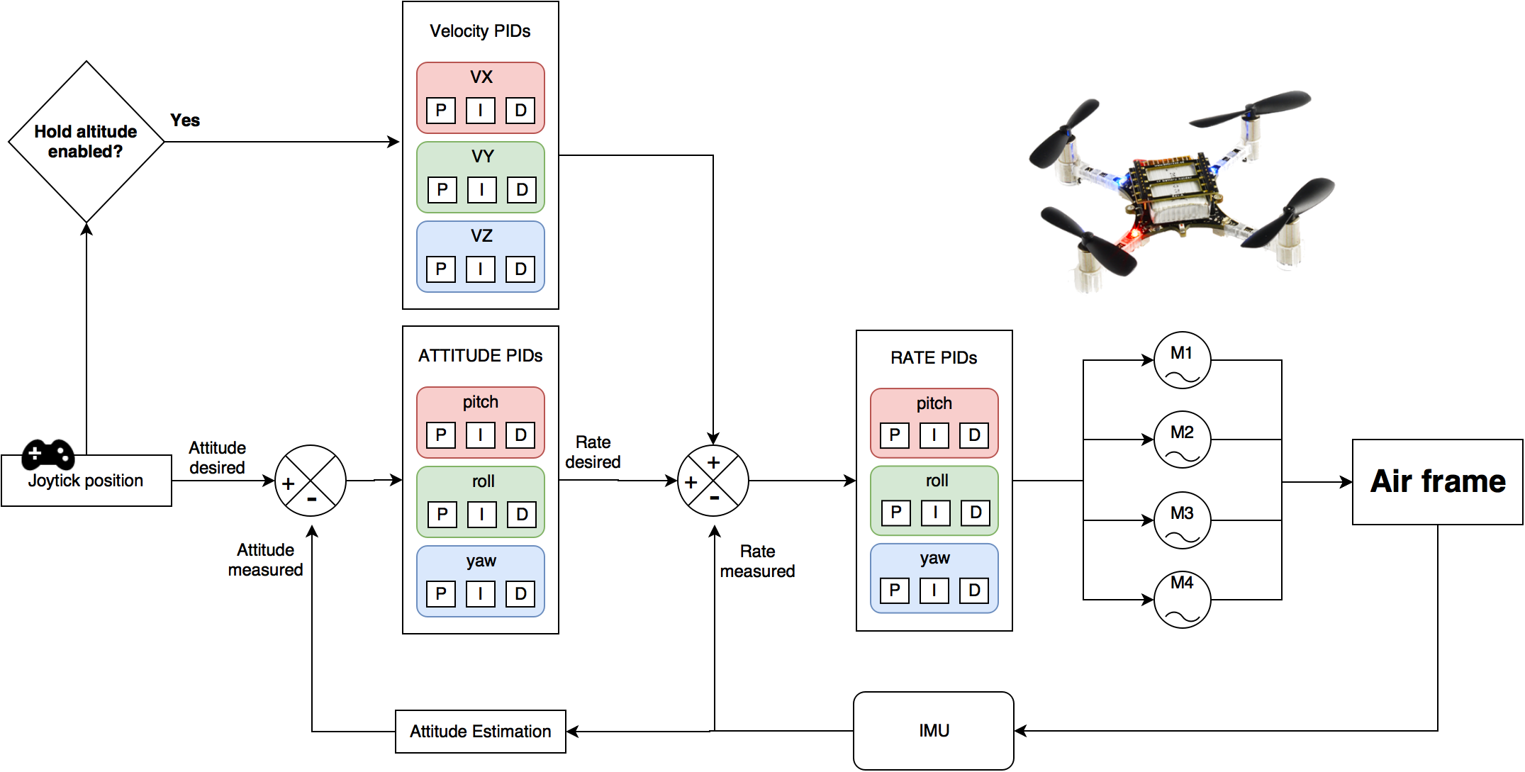

Indeed I'm try to make a flow diagram of the PIDs present on the Crazyflie 2.0.
This is just a first draft and I believe there might be some errors. Meanwhile, I would approcciate some feedback and/or suggestions.

Posts: 2538
Re: Hover mode | accelerometer?
Post by arnaud »
Hi Jassy,
Wow this is very beautiful! Have you done is with inkscape?
Though the diagram is not accurate:
- You are missing the thrust, which is what altitude hold will be eventually driving
- Maybe you can represent the power distribution: the output of the angle PID will be torque-like and the output of the thrust PID will be force-like (they are currently expressed in PWM, but they are really torque and force). The power distribution block is responsible for translating these force and torques is individual motor control.
- The velocity loop will generate the attitude setpoint for the attitude loop. What altitude hold is doing is to multiplex the attitude loop thrust input from direct gamepad control, to velocity loop output.
Best,
Arnaud
jassi0709
Posts: 22
Joined: Fri Nov 25, 2016 4:35 pm
Post by jassi0709 »
Hi Arnaud,
I was aware of few inconsistencies. I will check your comments, add more details and then post it again during the weekend.
I actually used draw.io, but maybe I should use Inkscape... :D
I've also managed to achieve a better hovering which I will share soon as I can.
Best regards,
Jassy
