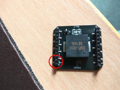

Could you upload a picture of the board so it's possible to see the soldering and markings on the buzzer?

Sure, here they are. I hope, everything important is shown.

To me it sounds like the buzzer is broken then, which is kind of strange as it is a robust part. Could you send an email to support(at)bitcraze.io and we will arrange a replacement board for you.

The buzzer uses the two marked pins in the photo. Could you check so that these have proper contact with the expansion connector?
- Buzzer PWM pins

@marcus: I checked the pins and their contact to the board. These have a proper connection. But I got another idea to check the integrity of the buzzer: If I got that right, the 2 pins should be connected by the piezobuzzer. I checked this with a gauge. It seems like these pins are not connected to each other. Furthermore I checked, if there is a connection between the 2 big soldered points of the buzzer. But these don't have an electronic connection on this board, too. Is this an indication for a broken buzzer?
