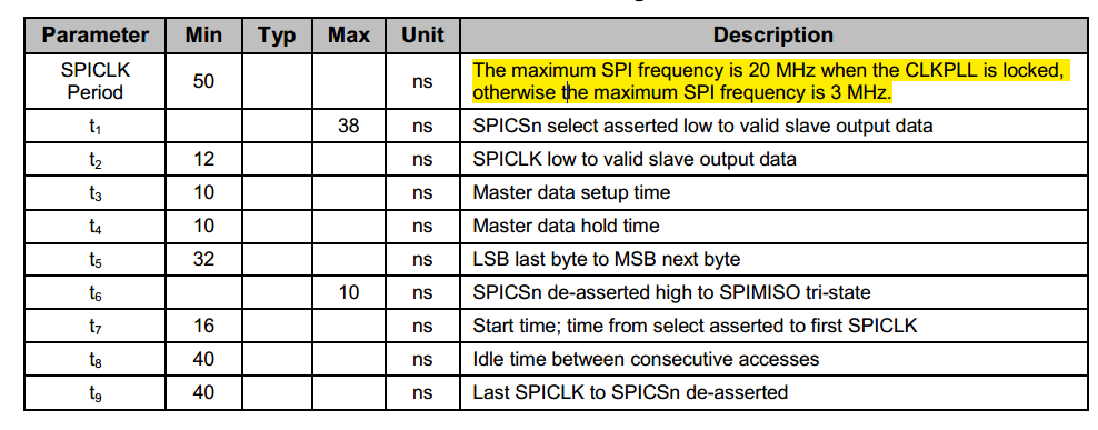

hi,
I check the lps-node-firmware code, find the spi speed is 3M clcok, according to the dw1000 spec, when the the speed may reach 20MHZ.
the dw1000 user manual record the following:
In the IDLE state the DW1000 internal clock generator CLKPLL is locked running and
ready for use but is gated off to most circuitry to minimize power consumption. In the
IDLE state SPI communications can operate at up to 20 MHz, the maximum SPICLK
frequency.
so we maybe try the 20M clock? or faster than 3MHZ?

Yes there is a lot of optimisation possible there. The node already has double speed, a slow and a fast one. It is setup there: https://github.com/bitcraze/lps-node-fi ... #L139-L146. The fast speed is "only" 12MHz because it has to be an integer division of the CPU clock and the CPU is currently running at 48MHz. Maybe we could try 24MHz or reducing a bit the CPU clock. Though I did not see much improvement with faster SPI and I suspect it comes from the interrupt handling: we might need DMA.
Mike Hamer actually solved it in his crazyflie firmware fork: he implemented the SPI with DMA and with fast speed (21MHz). I have just merged the pull request from mike so thanks to him this is now fixed on the copter. We just need to do the same on the node :-).
The next subject on SPI though is the efficiency of the driver: I feel the current DW1000 driver is not optimized and might be communicating more than necessary which can limit the ranging speed.
