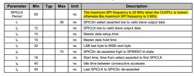

hi,
I check the lps-node-firmware code, find the spi speed is 3M clcok, according to the dw1000 spec, when the the speed may reach 20MHZ.
the dw1000 user manual record the following:
In the IDLE state the DW1000 internal clock generator CLKPLL is locked running and
ready for use but is gated off to most circuitry to minimize power consumption. In the
IDLE state SPI communications can operate at up to 20 MHz, the maximum SPICLK
frequency.
so we maybe try the 20M clock? or faster than 3MHZ?
