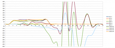

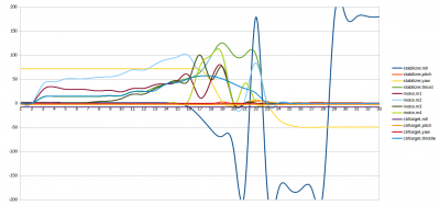

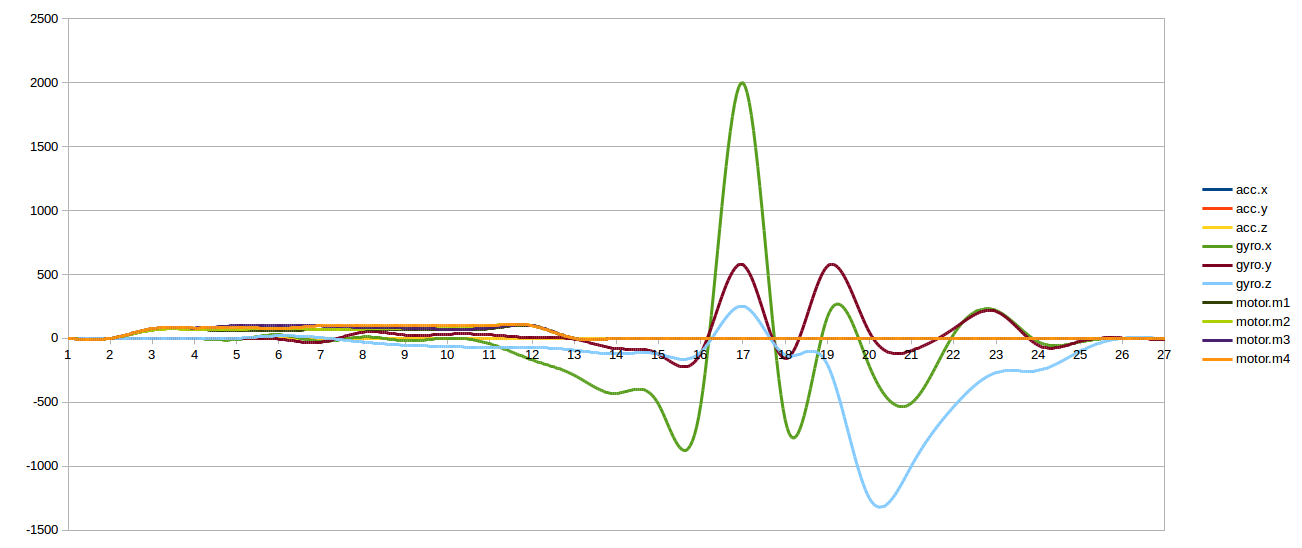

Unfortunately, my crazy is really crazy and still crashes. I fly in advanced mode with new PID coefficients. Here you can see the instant of the crash in a flight log including the command by xbox (ctrltarget...).
The values of the parameter are given in the attached file.
The time in abscissa is 12 for 1 second. Throttle (throttle for ctrltarget...thrust) and thrust are in %.
Motor M4 has 0 command until time 12. Then it runs and the crazy starts an uncontrollable roll... M4 is a new motor.
At start crazyflie was stopped horizontal. Beginning of the flight was correct.
The end is on the back.
I think there is some electrical problem due to mechanical shocks?
regards
Jean-Claude

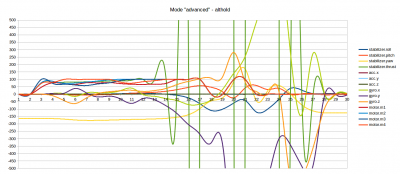

Re: New pid coefficients
Hi Sean

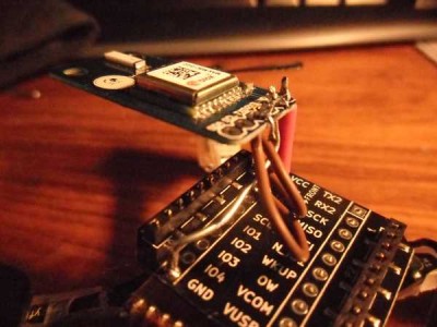

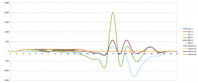

New flight this afternoon to test althold. Althold mode is initiated at time 0, with initial thrust 100%. I installed the GPS deck so craft is rather heavy.The phenomenon appears quite similar, as can be seen underneath: and with larger ordinates: The instability appears after 1 second, and I immediately stopped althold mode.
I sincerely hope that you can find some explanation. I begin to
Regards
Jean-Claude
Does it do the same thing with the old PID values? Try setting the Ki terms to zero (just the rate ones that are currently 500). That graph looks like it could be integral wind up and overshoot.

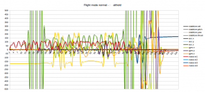

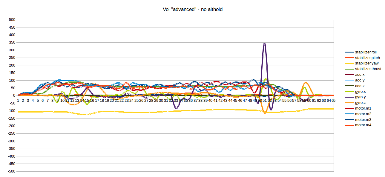

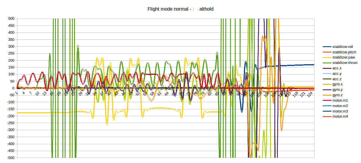

Hello Sean

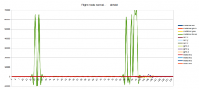

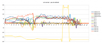

The afore tests were done with a payload, namely gps: I did 4 flights without payload:
Normal flight mode, free flight (no althold):
JeanClaude Good. Normal flight mode, althold: and with different Y-axis: Advanced flight mode, new coeff, free flight: Excellent. Advanced flight mode, new coeff. althold:
Please see next post.
Payload seems to play a role.
