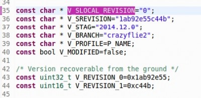

When clicking "Update all Projects" in the Virtual Machine (version 0.8) and then opening Eclipse and watch the version, it says something 2014 which doesnt seem right I think. Please see attached screenshot. In github I see that there was modifyings 3 hours ago... Or did I misunderstood the system?

The crazyflie-firmare repository on the Bitcraze 0.8 is on the older "crazyflie2" branch. You need to change it to the master branch to get the latest:
cd ~/projects
git checkout master
git pull
