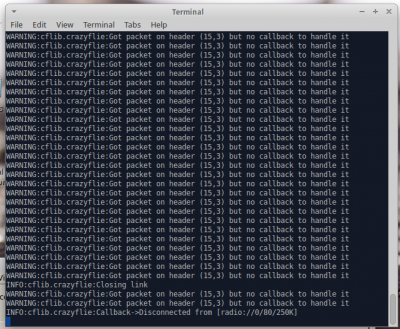

Let me start off by mentioning that I'm using a Macbook Pro. I am able to get my Crazyflie 2.0 connected to the Crazyradio PA dongle. However, after connecting I get this persistent warning dialogue like so:
Warning
Warning
I'm a beginner to all this and would really appreciate some assistance with this problem, That's only 1 of my many problems. I'll post the other problems soon.

I flashed the .bin file at the link you mentioned. I used the Mac Wireless Diagnostic Tool and selected one of the best 2.4 GHz connections. The information on the console was this:

This is my fault and it has been fixed in the develop branch of the client. This warning is not important so much that my fix was just to remove it: https://github.com/bitcraze/crazyflie-c ... 5dc420L394
The origin of the problem is that I added a packet to return the signal strength from the copter, I piggy packed the signal strength on a NULL packet (the packet (15,3)). This should just be ignored by the client until we use it but instead a warning was printed.
The curious thing is that if you run the last released Crazyflie firmware (the .zip from github https://github.com/bitcraze/crazyflie-r ... /2015.08.1) with the latest released client (the master banch) you should not see this.
If you use the trunk firmware for stm32 and nrf with the client from the develop branch you will not see this warning either.
