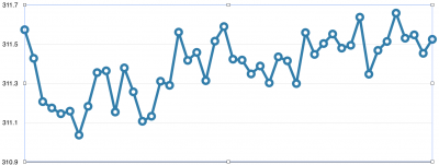

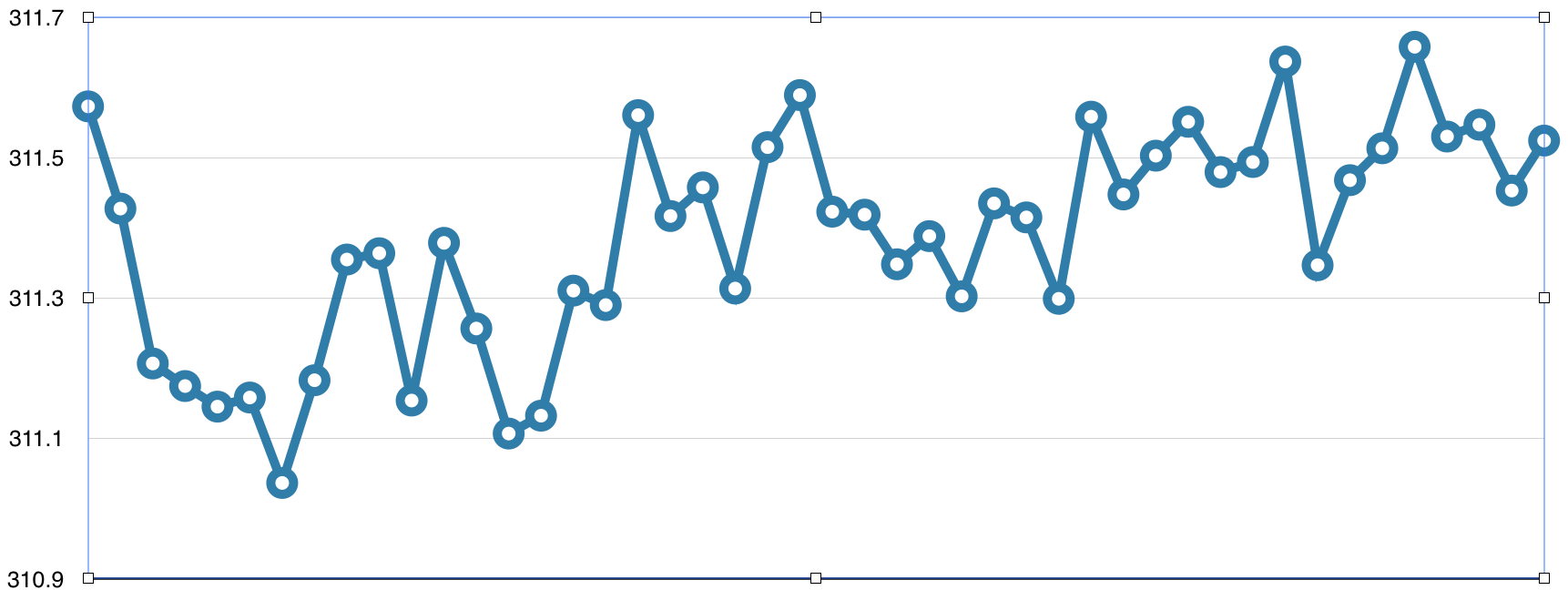

It was really interesting, this turbulence. The room is rather large with a high ceiling. There are vents low on the walls on opposite sides of the room, offset from each other. The furnace (and thus the blower) are very new and quite strong (great for winter!) and the vents are nearly right above the furnace so there's a very short path from blower to vent - the shortest in the house.
Anyway, the vents create a cross-wind that makes for a layer of wind shear about two feet off the ground. When I'd lift off, (thus under high thrust and battery load) the Crazyflies would get jostled around in what certainly looked random. When the stabilizer code tried to correct, it sometimes would oscillate and make flight really, really wobbly. Near the center of the room, presumably as the heat rises, there is a pillar of turbulence that would cause all sorts of flight disturbance. I could even, pretty consistently, get the altitude hold to get into this bouncing pattern that was pretty fun to watch but rather frustrating to fly with (the graph looks cool though).
