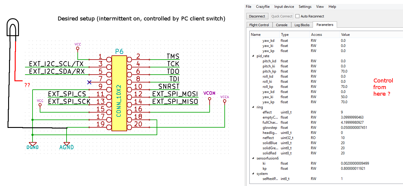

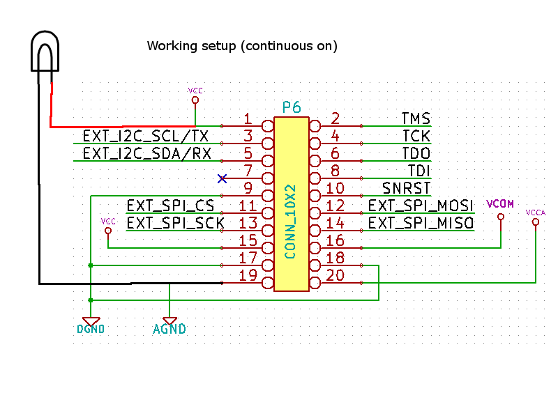

I have a simple bulb light that requires 2.6-5 VDC. I have connected it to the CF expansion header, pins 1 VCC and 19 AGND. It lights as expected. It is always on, as long as CF 2.0 power is on.
Now, I would like a way to turn the light on and off with a remote button (game controller or keyboard). I currently use VJoy to pilot via keyboard. Is there an available pin on the expansion header that can be controlled from the PC client? The ideal pin would be able to put out an analog 2.6-5V DC when active, and 0 DC when de-activated (perhaps pin 7?) A substitute could be PWM 0-3V PtoP on activation (perhaps pins 2 or 4?).
Is there a way to control a simple analog switch on the CF the expansion board from the PC client? If possible, I would like to do this with no additional circuitry or hardware, and without a firmware update to the CF. I can write software to do this if that is required, but I am hoping that this capability was already built into the CF 2.0 for expansion purposes.

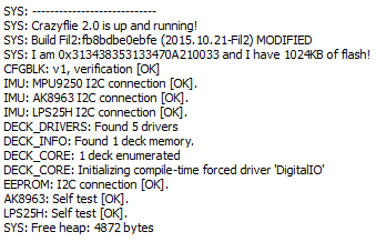

4. Finally, compile and flash your new firmware. My Client console appears as shown in the attachment.
5. Attach positive LED wire to Pin IO_1 / PB8, and negative wire to GND. It will light!
I love Crazyflie!!
