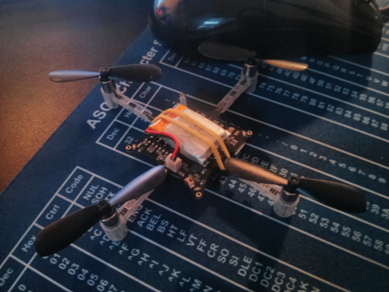

I recommend to use velcro tape to attach the LiPo on the CF for faster battery exchange. It is also very well to find the perfect Balancing during the assembly.
marcus
Posts: 659
Re: Larger battery? 340mHa (plus 1 gram camera)
Post by marcus »
Another method (if you don't have access to velcro tape) is using a small rubber band like this:
/Marcus
