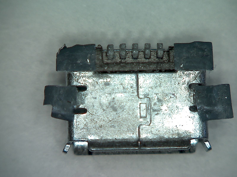

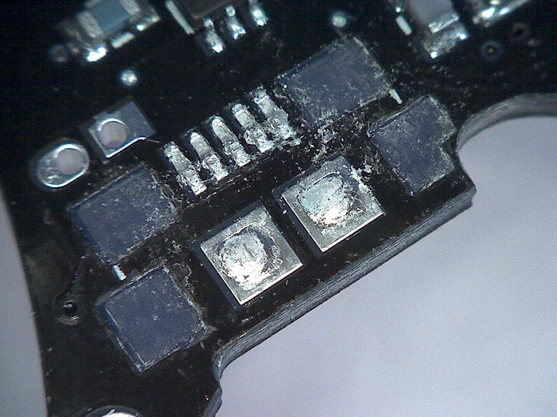

Thanks for the quick reply. Attached are photos of the torn-off USB jack (pads facing up) and the mounting location on the CF board. It definitely looks to me like the solder pads have torn off with the jack; the color is off, but in case the board photo isn't clear, the four surfaces where the jack should attach to the board are a dull non-metallic brown, while the other surfaces are shiny metallic silver. Do you still think some kind of glue might reattach the jack strongly enough?

It looks like the physical mounting pads have indeed been pulled off the board. However, the actual USB connections look like they may have been cold solder joints in the first place. They look okay. Maybe some extra solder but the pads are still there.
How good are you with a soldering iron? Have you done SMD soldering before? You might be able to just reattach the usb jack using those 5 tiny pins... And then use a bunch of hot glue as the actual physical connection.
Be careful with those pads though... and maybe you can solder everything up with a usb cable in the jack itself so you can do a quick connectivity test before you put hot glue on the thing...

Jamisnemo: Interesting idea. I had assumed, since the five tiny traces on the board looked so shiny and undisturbed, that there never was any solder on them and that the pins on the jack were just being held against them by pressure from the mechanical connection. Can you state authoritatively that the pins are normally soldered to those traces in these Micro-B situations?

Those pads definitely had cold solder joints. Which is probably why the pads didn't get ripped of along with the USB connector (like the mechanical pads did). This type of connector is definitely meant to be soldered on.

Those pads are not electrically connected so you can use them without any problem.

@Tobias: Yes, the connection between the cable and the jack was incredibly tight. I realized this the first time I charged it and tried to be gentle -- not gentle enough. Like san84, I tried two different cables, so I feel safe in blaming the jack, particularly since I'm being told the solder joints on the five traces look cold. It occurred to me that the two big square pads might also be intended as mechanical solder connections for the jack, and if so, they look to me like they were also weak (if they were even soldered at all.)
Update on my progress: I bit the bullet and attempted to remount the USB jack. I was much too optimistic about my ability to solder surface-mount. I got the jack mechanically soldered to traces 1 and 5, figuring I'd do the other traces after I tested the charging connection -- which was in fact bad. In the process of desoldering to try again I ripped traces 2 and 3 off, and trace 1 was left hanging by its far end. So, no USB data connectivity for me, ever. But: I was still able to attach a piece of 1x2 female 0.1" header to trace 5 and the ripped trace 1 (the power traces), anchoring it at the big square pads; it seems mechanically sound and, after decapitating a USB cable and slapping some male header on it, the CF charges just fine. The edge of the header extends out beyond the edge of the board; because of this and/or the weight difference (I'm betting the header + mechanical solder globs are heavier than the USB jack) I think maybe the CF is now a little wobblier on descents than it was, so I've decided not to possibly aggravate the situation by putting any hot glue on for now.
