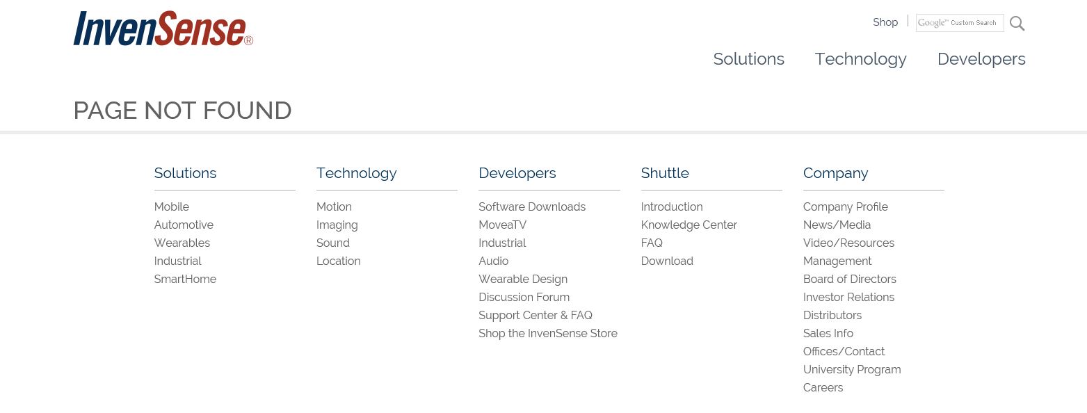

Link no longer works.
Can you post a working one?

The info on the MPU-9250 is here.ThatFlieCray wrote:Link no longer works.
The direct link to the data sheet is here.
Page 5, section 1.3 (Product Overview) describes the chip.
