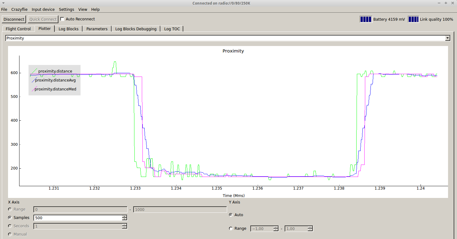

The proximity system includes a simple function for calculating the average of samples in a sliding window. The sliding
window is configurable for number of samples in window.
Distance measurements are made available to cfclient by both the MaxBotix driver as well as by the proximity subsystem.
