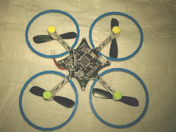

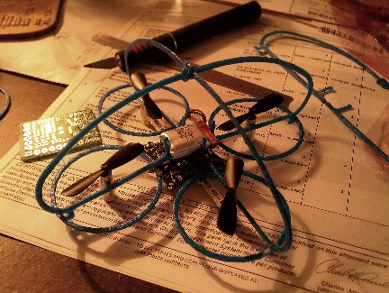

See fun things to do and protect your Crazyflie!
Frame Protection
http://www.thingiverse.com/thing:84169
Motor Bumper and foot pads
Bottom CF.jpg (58.44 KiB) Viewed 14288 times
USB Protection
http://www.thingiverse.com/thing:84295
Prop Protection
http://www.thingiverse.com/thing:87149
Protect your Motors and Props
