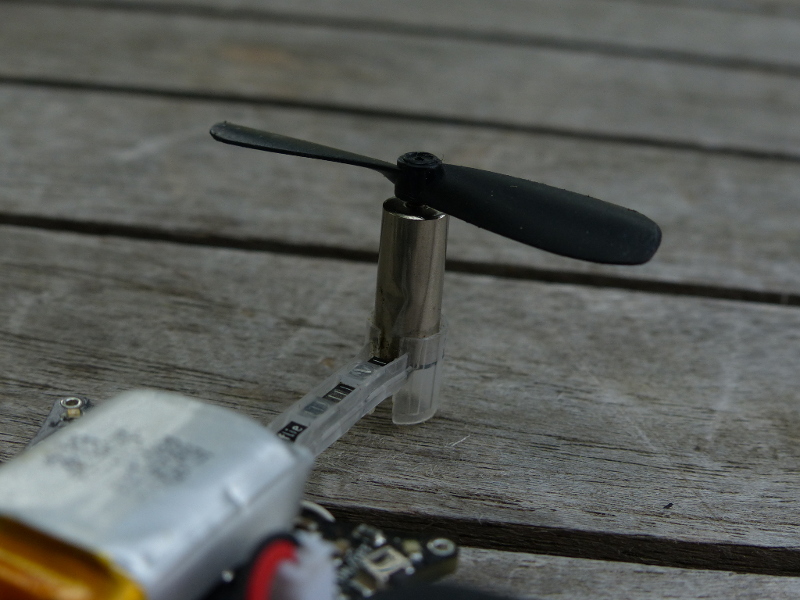

Sorry to hear about the motors :( There's a "stop" that has been put in to protect the motor from damages from the PCB arm. The same kind of "stop" has been put in beneath the motor to protect the bottom of the motor/wires when lading/taking off. We will have a look at the design again and see if there are any adjustments that can be made.
One method for extra motor protection can be seen here.
/Marcus

phiamo wrote:Your link is self referencing :(
Sorry about that, here it is

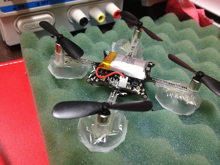

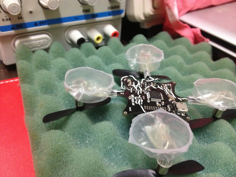

I cut some "package bubble" from previous delivery box and put them on each arm of my crazyflie.
It can provide not only a better protection than a tape but also keep light weight.
I hope this may help saving more lovely crazyflies.

Sorry to bump this topic, but I have another solution for "the dent" problem.
I have added some Styrofoam bits to my crazyflie.
Works well. Image
