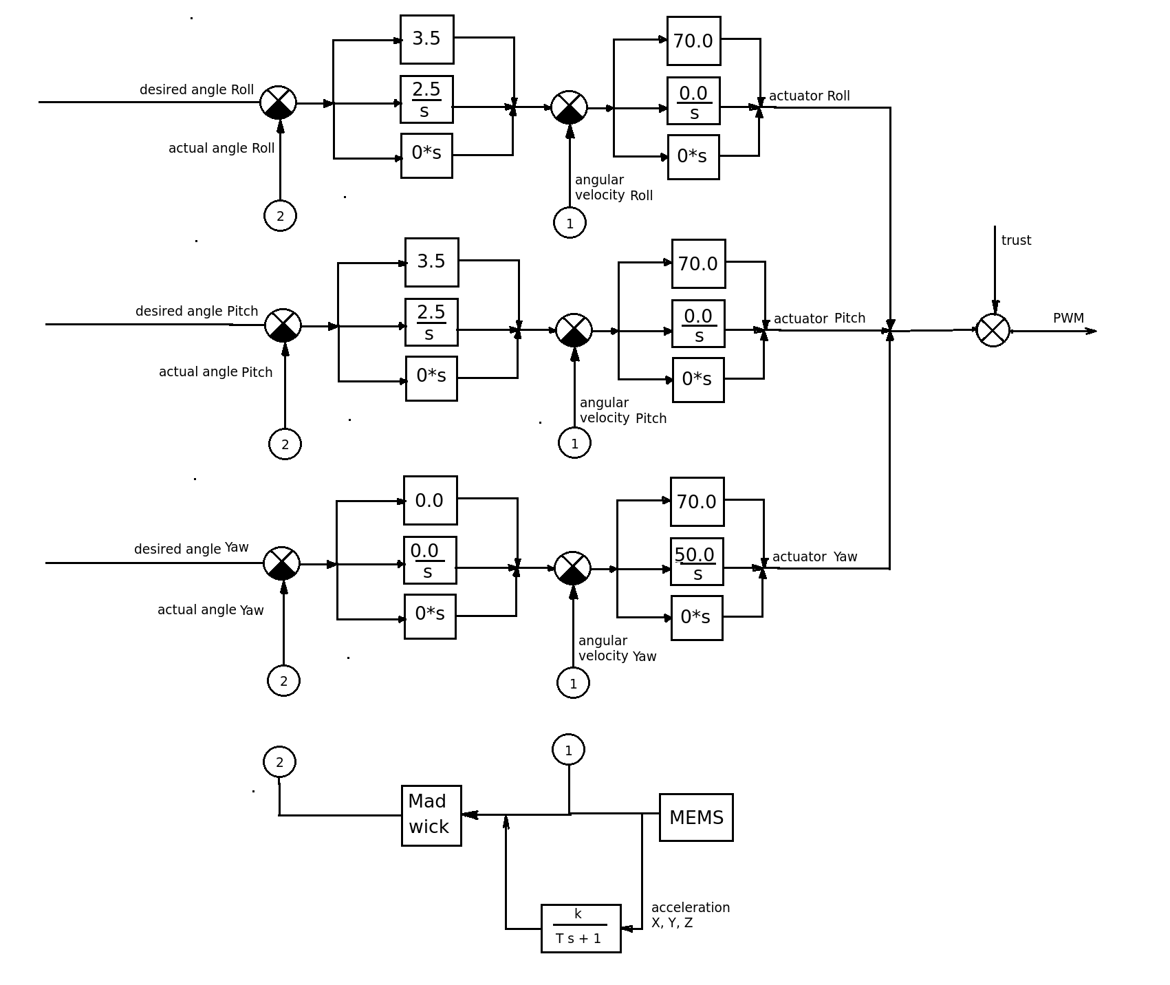

Hello. I looked to stabilizerTask() function and made flowchart of stabilization control system ( see Picture in attachment ). So, is i right understand the mechanism of stabilization?
Now i am interested in realize mechanism of vertical movement. For example, to quadrocopter raised to a certain height. After reaching the desired height hovered on it. I think there is must be some block attached to stabilization system. And input of this block must be the desired height and output - "thrust" signal on picture. Is this block can be maided as PID regulator? I would like to understand how to develop a control system. How has developed a stabilization system ( stabilizerTask() ) of Crazyflie - Is there is used a typical scheme of control system theory? Can you point me to used literature? Thank you)

Re: crazyflie control system
Yes it you can. The cascaded "PI + P" actually becomes a PID as the derivative of the angle is the angular speed, thus "D" in the PID. The benefit is that the angular speed controller can run at a faster update rate then the angular controller, saving computational power.Is it possible to replace used two PID controllers with single PID, which take as input - angle error and gives the actuator thrust as output?

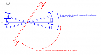

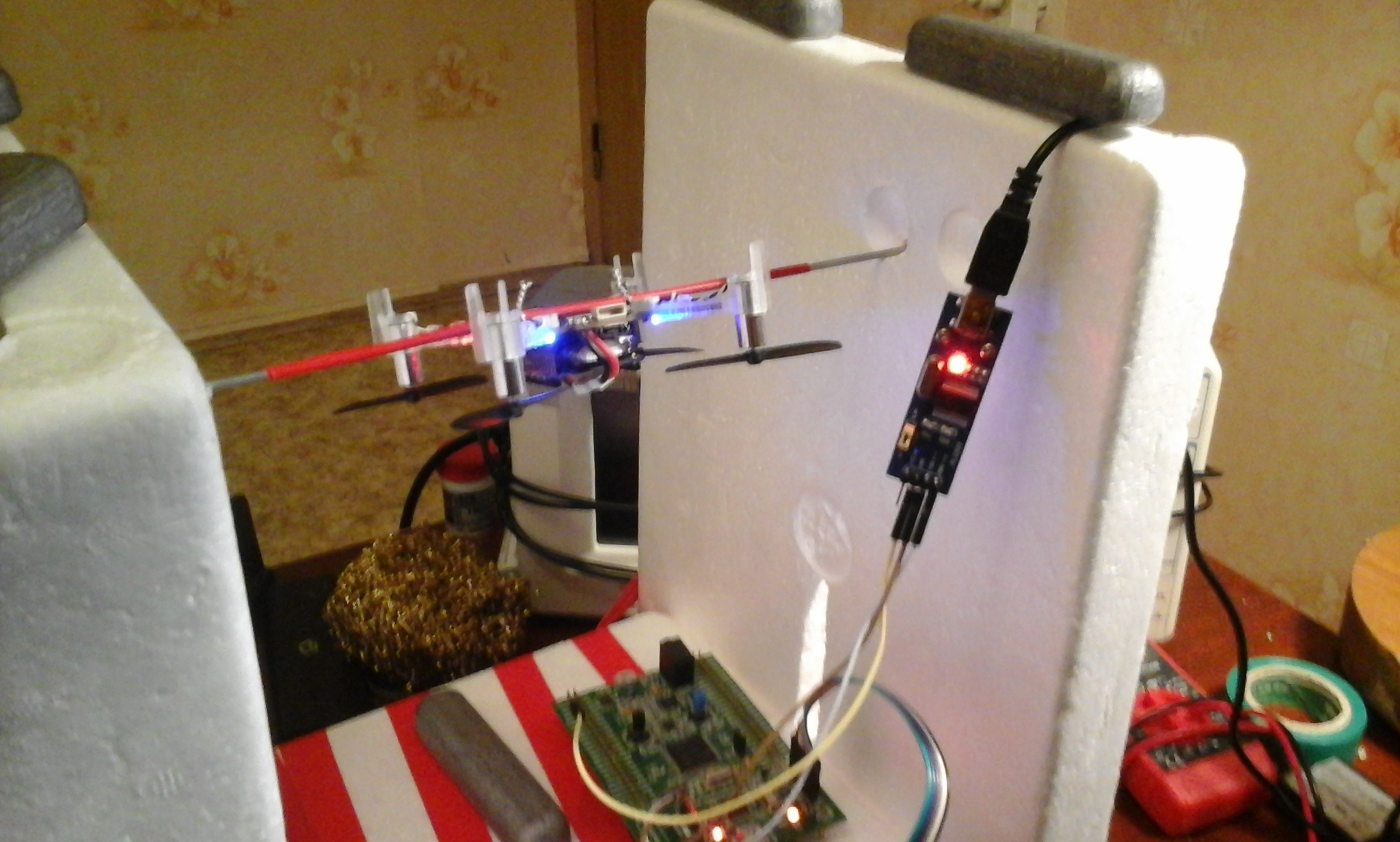

Is it right algorithm to tune PID?
1) I mount my quadcopter on stand so that quadcopter can rotate around just one of axis.
2) set Ki = 0 and Kd = 0
3) step by step to increase the Kp and at some point get oscillations of quadcopter around the axis of rotation without tipping upside down of my quadcopter?
thank you for answer.
That'd be correct for controlling on a per-axis basis, yes. You should be able to find a point where oscillations are minimized using that method. Be sure to understand how pitch and roll are being calculated and corrected in the x configuration versus the plus configuration too. X configurations require input from both the pitch and roll sensors based on the orientation of the accelerometers. This can lead to a more stable and maneuverable platform, but the math requires both pitch and roll PIDs to be tightly coupled over time for true stability rather than marginal stability.
I will note that the Kp for pitch and roll should be shared, especially in X configurations. You could separate them for a plus configuration, but unequal values will give one dimension much more stability, and the other will be more maneuverable. Good for "linear" flight (Airplanes), not so much omnidirectional flight (Quads).

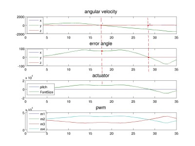

No, it is impossible to get oscillations using only P coefficient!!!
See first picture. At starting position quadcopter placed horizontally. Then it falls down to left side until the generated actuator does stop falling ( point number 1, angular velocity = 0 ) and return it back to gorizontal position ( point number 2, angle error = 0 ). But!!! In point number 2 the angular velocity is not zero!!!! There is must be Kd coefficient that press down angular velocity to zero!
