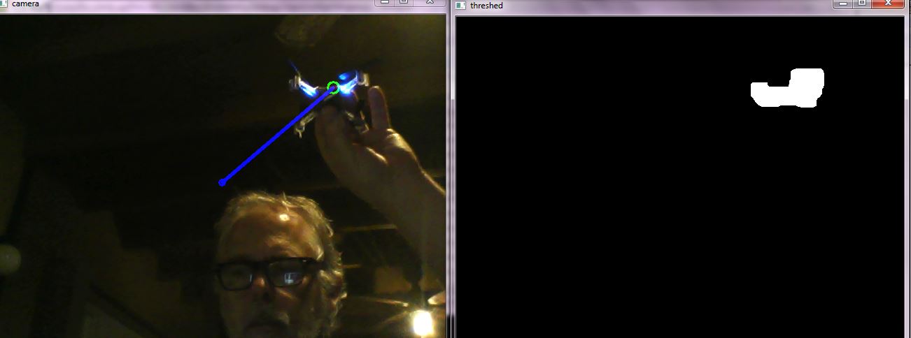

Still haven't destroyed our two CF 2.0's and hoping to snake in some hover assistance using OpenCV with a webcam. The blue LED make for good tracking (except when the lights bounce off my shiny forehead...).
I've cobbled together some inline python code based on OpenCV examples, and I'm looking for some helpful hints where/how I might best integrate and dial in some offsets into the cflient to help hover. I haven't poured through all the traffic here yet (apologies), but would appreciate any suggestions.

Working off this: https://github.com/jessicaaustin/roboti ... tracker.py
She hooked a camera up to it, which should make for a decent tracker, at least until it crashes into my forehead seeking blue reflections...
