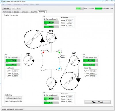

NEW Tab design and propeller acceleration values will be displayed.
And DEBUG_PRINT() outs has a higher information level, too.
MPU6050: M1 Condition:69% (X:0.84, Y:1.22, Z:0.83) [OK]
MPU6050: M2 Condition:82% (X:0.80, Y:0.79, Z:0.73) [OK]
MPU6050: M3 Condition:62% (X:0.83, Y:1.48, Z:0.99) [OK]
MPU6050: M4 Condition:75% (X:0.98, Y:0.79, Z:0.79) [OK]
MPU6050: Propeller Balancing Self Test [OK].
MPU6050: Propeller Balancing Self Test: Finished.
The formatting is not so nice but the print out string is limited.
CF FW (balancing mod):
Source: Bitbucket Link CF FW
CF Client (balancing mod):
Source: Bitbucket Link CF Client
Suggestions for improvement are welcome!

KOschi wrote:is there an easy way to install these tab in my crazyflie VM? I have no clue how to do that and can´t find an nice FAQ part.
Sorry KOschi i've missed your post. Yes, a nice "How-To.." for that is missing. You can use the TortoiseHG Workbench or i prefer the Mercurial plugin for Eclipse (Eclipse->File->Import->Mercurial->Clone existing Mercurial repository).

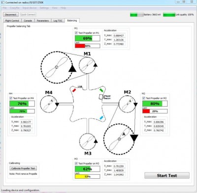

Another short change note:
- Progress-bars shows the condition with colors (red<=40, yellow<=60,green>60)
- Tests can be stopped with the Start/Stop toggle button
- And last but not least the calibration values will be stored in the client (power cycle of the CF is now possible without using the bad default values or a new calibration every power cycle)
