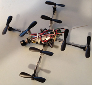

Tobias/everyone,
I'm still working on my double-motor configuration w/ FPV. Double motors allows me to carry a 600mAh battery and fly for over 10 minutes! I took your advice and used the VCOM (Pin# 16) and DGND for my FPV transmitter that I bought from FPVhobby.com. After hearing that 2.4Ghz can cause interference with the control frequency, I went with a 1.3Ghz 50mW tx that draws 180mA w/ the camera. I also have a voltage regulator (5V step-up from Pololu) that I haven't installed yet.
2013-10-06 21.30.11.jpg (48.24 KiB) Viewed 18468 times
Heres my problem:
The problem is that when I throttle up, I lose control connection with the crazyradio. The Tx works fine-- even at full throttle I get a pretty clear picture with only minor distortion from engine noise. Eventually, the camera will drop out once output voltage gets below 3.4V (which is why I will install the 5V step-up soon). To troubleshoot, I've disconnected the camera and throttled up, and the control link stays solid (flashing green light & full control). Plug the camera/tx back in to VCOM and I lose control link as soon as I throttle up. When I plug the CF into a USB power source and establish a link, the control link holds fine at full throttle--even with the camera/tx plugged in.
Based on my findings, I think the battery doesn't have enough power output to handle eight motors at full throttle and a camera/Tx (180mA). Would this make sense? If I went with a lesser power transmitter (10mW tx at 140mA instead of 180mA) do you think that would make a difference? Should I get a higher output (30C?) battery? Can I configure the PCB in any way to increase current from the battery?
Thanks for your advice!
Ryan
Re: Crazyflie w/ Double Motors
Posted: Mon Oct 07, 2013 8:10 am
by tobias
Very nice build, like it a lot!
We have noticed similar problems, that when the system gets too loaded it tend to drop the radio link. As a first simple test try switching to 2M datarate on the radio. It might decrease the radio distance but we have noticed that the link is more stable during heavy loading.
Posted: Tue Oct 08, 2013 12:23 am
by absoloodle37
I tried switching to 2M, using various channels but that did not work. The CF lost signal as soon as I got a few feet away from the crazyradio. Considering the camera draw is 180mA, should I switch the camera's power source to VCC (rated up to 200mA), or would that not help? I guess I would run the risk of overheating the VCC regulator...
I can also try to find a 35C battery and see if that would help, given the current of VCOM is rated up to 4A. I could also return the 50mW TX/camera (draws 180mA) and get a 10mW TX/camera (draws 140mA), or do you think the 40mA decrease in current consumption won't help? Also, do you think the addition of the 5V step up regulator would help or hurt the situation? I can fly without it for a short period of time...
I guess the last resort would be to pack a second battery dedicated to the camera/tx, but the extra battery and cabling means extra weight.
Obviously I can try all these options, but which one should I try first? Thanks for your thoughts on this!
Ryan
Posted: Wed Oct 09, 2013 7:09 am
by tobias
I would try the 5V step-up connected to VCOM and DGND as a first step. That will help isolate the systems from each other.
