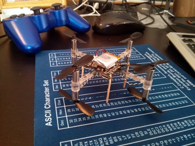

A tip for the landing gear. I found some tooth picks at home, cut them in half and inserted them into the extra holes on the PCB (sharp end first). The ones I have look like standard toothpicks and I think they would give enough clearance for the motor/propeller at the bottom.
Toothpick landing gear

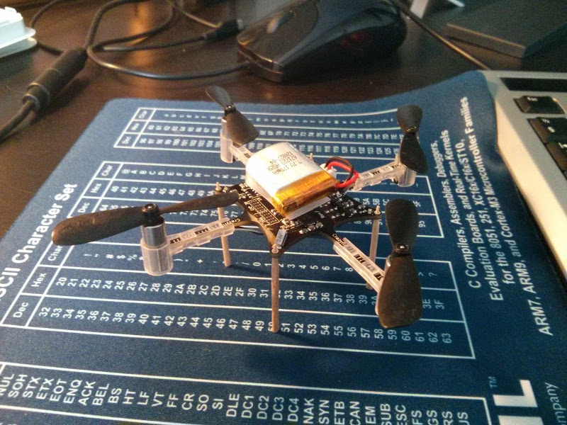

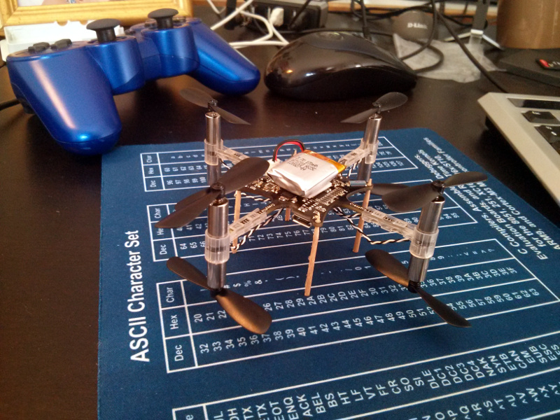

I really had to try this myself, so I assembled a new Crazyflie with dual-motors. It's actually really fun to fly :D It feels like the Crazyflie is a lot bigger all of a sudden, but it feels more powerful. I haven't had a chance to go outside and try it yet though. I used the toothpicks as landing gear but they don't really hold up for a rough landing. Also I hit the wall once and one of the motors slid out of the mount and twisted itself around the motor wires.
Crazyflie dual motors
So the conclusion is that I need some good landing gear and probably to attach the motors so they don't slide out. I want to use hotglue for the motors, but if I need to exchange one of the motors I don't think I'll be able to...

marcus wrote:So the conclusion is that I need some good landing gear and probably to attach the motors so they don't slide out. I want to use hotglue for the motors, but if I need to exchange one of the motors I don't think I'll be able to...
Maybe you can solder two motors with a stiff wire like this:
attach the motors with a soldered wire
And for the landing gear are soldered stiff wires maybe a solution, too. (like the Training wheel)

Thanks for the tip. I'll try to cut a circular pad of the sticky white tape that's used to attach the battery and try to stick the motors together that way. I think they will hold enough for a crash but still it's possible to pull them apart without causing damage if you need to exchange one of the motors.
Unfortunately the wire used for the protective frame is at Tobias house and he's on vacation, but I'll try to find something else. A 3D printer would have been handy to have now.
