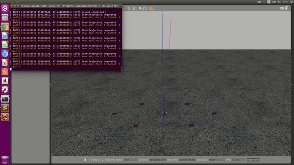

I have recently push some modifications on the multi-uav-final branch. You will have to clone/pull the project and go to that branch for sim_cf. Be sure that the submodules external/crazyflie_comm and crazyflie-firmware also points to multi-uav-final branch. This branch breaks most of the things implemented in the master branch that's why I wanted to be fully tested before making it the master branch. We managed to fly 7 crazyflie with this new version of SITL. Check the branch readme.md of crazyflie_gazebo for testing procedure. Message me or leave a message here for implementation details or erratic behavior.

The multi-uav-final branch works fine for me with 5-6 cfs, but not 7. I compared my CPU (Intel® Core™ i7-6700HQ CPU @ 2.60GHz × 8 ) with yours and its an expected result I guess (I have same RAM size).
When it comes to HITL, I wonder did you ever tried to fly multi cfs in HITL mode, or a single one maybe? If you do try and succeeded, what feedback do you use (Vicon or LPS)? We have LPS system, about to be installed. Yet I am not sure if we can integrate LPS into the current directory of yours to try with HITL mode (since there should be another package must be added for LPS system and I doubt that messaging protocols will agree for position feedback). Thank you again.
Edit: By changing real_time_update_rate to 300 and max_step_size to 0.0033, I have good results with 7cfs.
