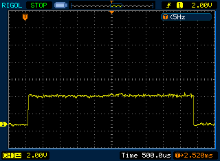

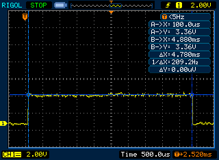

  • Verified the new address via sensor pin 2 by looking at the address announcement with an oscilloscope (pin 2 high for 4,8 ms on start-up represents 48 dec which equals 30 hex).
