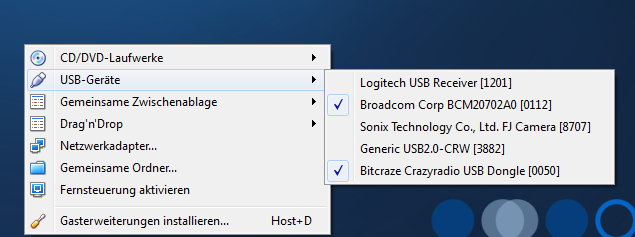

marcus wrote:After inserting the dongle and then starting up the Bitcraze VM in VirtualBox, if you go to the menu Devices->USB Devices (in VirtualBox) what devices do you see?
See attached photo, please. Sorry for the German interface.
tobias wrote:If the Crazyradio is detected/enumerated and the driver is working the Crazyradio should blink the red LED a lot when it is scanning for Crazyflies. Can you see if it does that?
No, it's not blinking at any time, unfortuantely. Only exception is when plugging it in - as mentioned above. I'm starting to get desperate. :(
usb devices.png (39.22 KiB) Viewed 905717 times
Re: Crazyradio on Win7/virtual machine
I'm getting the feeling it's a driver issue but in the VM everything is already set-up. I've send an email to the other guys, they might have an idea.

Just after connecting the dongle to the VM, can you open a terminal window and type "dmesg", it should display a lot of text ending with:
[  164.020130] usb 2-2: new full-speed USB device number 3 using ohci_hcd
[  164.297289] usb 2-2: New USB device found, idVendor=1915, idProduct=7777
[  164.297295] usb 2-2: New USB device strings: Mfr=1, Product=2, SerialNumber=29
[  164.297298] usb 2-2: Product: Crazyradio USB Dongle
[  164.297301] usb 2-2: Manufacturer: Bitcraze
[  164.297303] usb 2-2: SerialNumber: 6D07932721
Do you see something similar?

Yes, I do. It's included in this text:
bitcraze@bitcraze-ubuntu:~$ dmesg

[    1.543358] PM: Hibernation image not present or could not be loaded.
[    1.543368] registered taskstats version 1
[    1.546749] Key type trusted registered
[    1.549689] Key type encrypted registered

[    2.329787] usb 1-1: New USB device found, idVendor=80ee, idProduct=0021
[    2.329791] usb 1-1: New USB device strings: Mfr=1, Product=3, SerialNumber=0
[    2.329793] usb 1-1: Product: USB Tablet
[    2.329795] usb 1-1: Manufacturer: VirtualBox
[    2.348319] usbcore: registered new interface driver usbhid
[    2.348323] usbhid: USB HID core driver
[    2.371386] input: VirtualBox USB Tablet as /devices/pci0000:00/0000:00:06.0/usb1/1-1/1-1:1.0/input/input3
[    2.372440] hid-generic 0003:80EE:0021.0001: input,hidraw0: USB HID v1.10 Mouse [VirtualBox USB Tablet] on usb-0000:00:06.0-1/input0
[    2.485349] EXT4-fs (sda1): recovery complete
[    2.487442] EXT4-fs (sda1): mounted filesystem with ordered data mode. Opts: (null)
[    2.744317] usb 1-2: new full-speed USB device number 3 using ohci_hcd
[    3.212775] usb 1-2: New USB device found, idVendor=0489, idProduct=e031
[    3.212785] usb 1-2: New USB device strings: Mfr=1, Product=2, SerialNumber=3
[    3.212792] usb 1-2: Product: BCM20702A0
[    3.212797] usb 1-2: Manufacturer: Broadcom Corp
[    3.212802] usb 1-2: SerialNumber: 90004E9C5332
[    3.613048] usb 1-3: new full-speed USB device number 4 using ohci_hcd
[    4.082873] usb 1-3: New USB device found, idVendor=1915, idProduct=7777
[    4.082882] usb 1-3: New USB device strings: Mfr=1, Product=2, SerialNumber=29
[    4.082887] usb 1-3: Product: Crazyradio USB Dongle
[    4.082891] usb 1-3: Manufacturer: Bitcraze
[    4.082895] usb 1-3: SerialNumber: 1CAA81DDDE
The dongle is detected/enumerated, first step passed. When you run the cfclient and press the connect button and try after that the scan button on the pop-up window, still no blinking red LED?

tobias wrote:The dongle is detected/enumerated, first step passed. When you run the cfclient and press the connect button and try after that the scan button on the pop-up window, still no blinking red LED?
No LED activity at all, regardless what I do in the PC Client.
Hmmm, this is really strange. The radio chip, nRF24LU1+, on the dongle is obviously working otherwise the dongle wouldn't be found and the LEDs are also working, but it doesn't want to scan. I guess you tested different USB ports to rule out a problematic USB port?
When you run the cfclient there are some text output to the terminal you are running it from. When you press the connect button do you get:
INFO:cflib.crtp.radiodriver:v0.5 dongle with serial N/A found
alex
Posts: 137
Location: Germany
Re: Problems installing PyUSB and running CF PC Client
Post by alex »
tobias wrote:Hmmm, this is really strange. The radio chip, nRF24LU1+, on the dongle is obviously working otherwise the dongle wouldn't be found and the LEDs are also working, but it doesn't want to scan. I guess you tested different USB ports to rule out a problematic USB port?
I tried all ports without any change.
tobias wrote:When you run the cfclient there are some text output to the terminal you are running it from. When you press the connect button do you get:
No, can't find this line in the console after clicking the connect or scan button. There are some of those info lines but none with this content:
