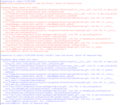

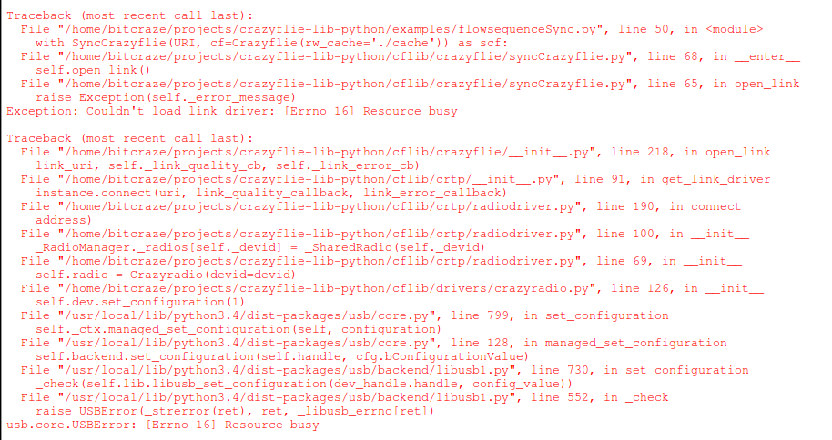

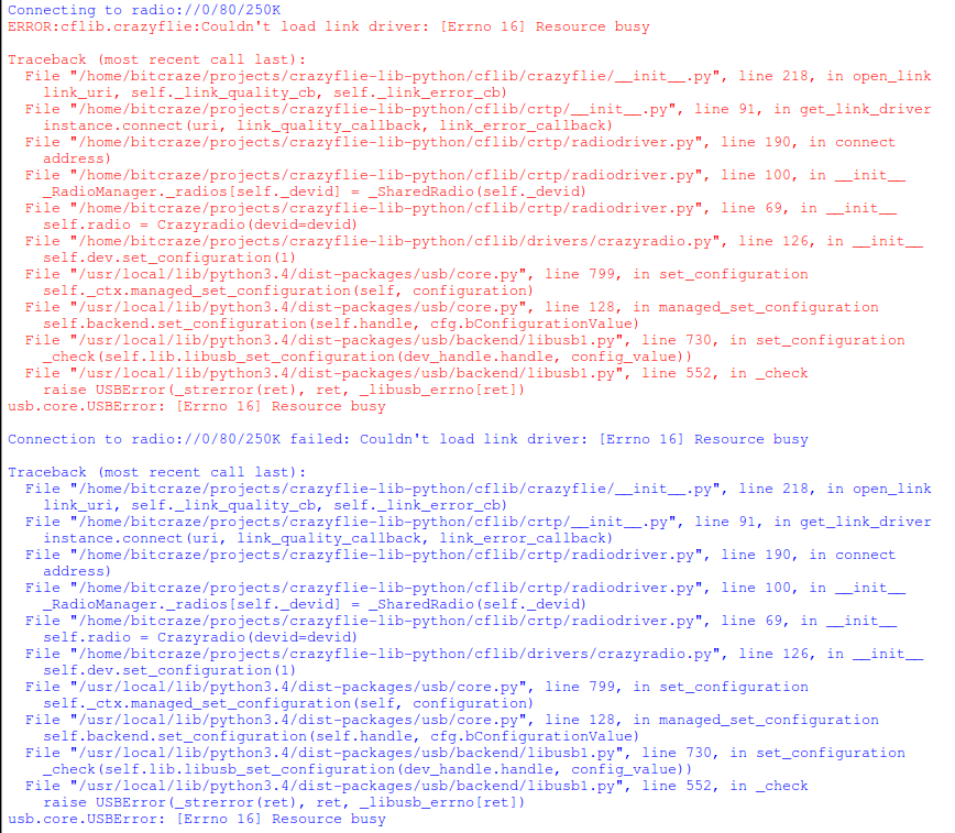

After successfully establishing a connection to the Crazyflie within the client (so that I was receiving real-time flight data), I proceeded to attempt to run a Python code. The code I chose was 'flowsequenceSync.py,' which is a pre-programmed flight path that seemed like a good starting point for testing. However, running the script produced an error output which I have attached in the two screenshots below (it is quite long, and I'm sorry for posting so much information especially since much of it is duplicated, but I figured I might as well show the entire error output). The problem seems to revolve around the radio or USB drivers, but I'm not sure how. The most common piece throughout the output is this "Couldn't load link driver: [Errno 16] Resource busy".
From browsing other forum posts, it seems like one potential solution may be to retry the whole process using the libusbK driver rather than the libusb-win32 that I am currently using. Could this be helpful? I am hesitant to alter my driver as it took a lot of time to get to the point where I am at now, and I don't want to lose progress by taking unnecessary steps.

It looks like you are running your python script while the client is connected to the Crazyflie. This is not possible since the will both wants exclusive control of the Crazyradio and it would explain the error message.
Have you tried to run your script without connecting from the client first?
- Posts: 9
- Joined: Mon Mar 05, 2018 5:43 am
Re: [Beginner] Help with Python Client
That solved it! My mistake, I just assumed that I would need to use the client to connect to the Crazyflie before I would be able to run Python code. Thanks for your help Arnaud!
