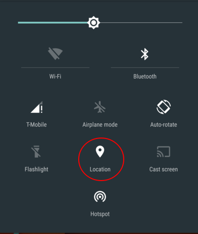

Could you provide a screenshot of the settings menu, where you have to enable the "localization function"?
This would make it easier to reproduce the error and fix it.

Hi I start it directly in phone options, simple as that
Just slide down bar menu where u have options like bluetooth, screen autorotation, etc. and there is also icon for localisation.
Re: Cannot conect by bluetooth
Do you mean the "Location" setting as seen in the picture below?

HI sorry for delay. Yes that's it
