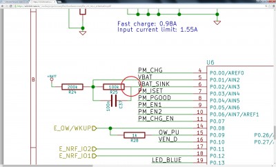

May I know if NRF51822 Pin 6 is connected R25 100K in the crazyflie2.0 schematic? I have mark it in the attached jpg. Thank you very much
