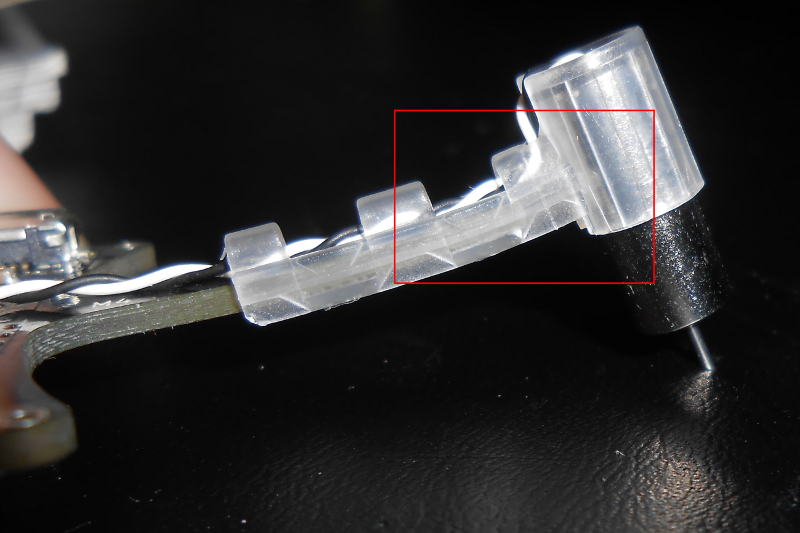

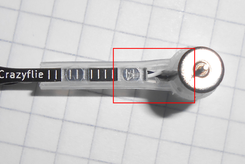

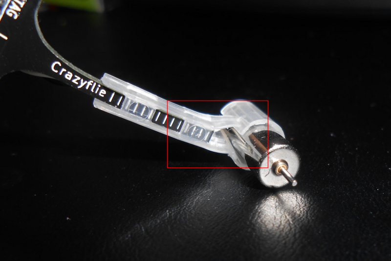

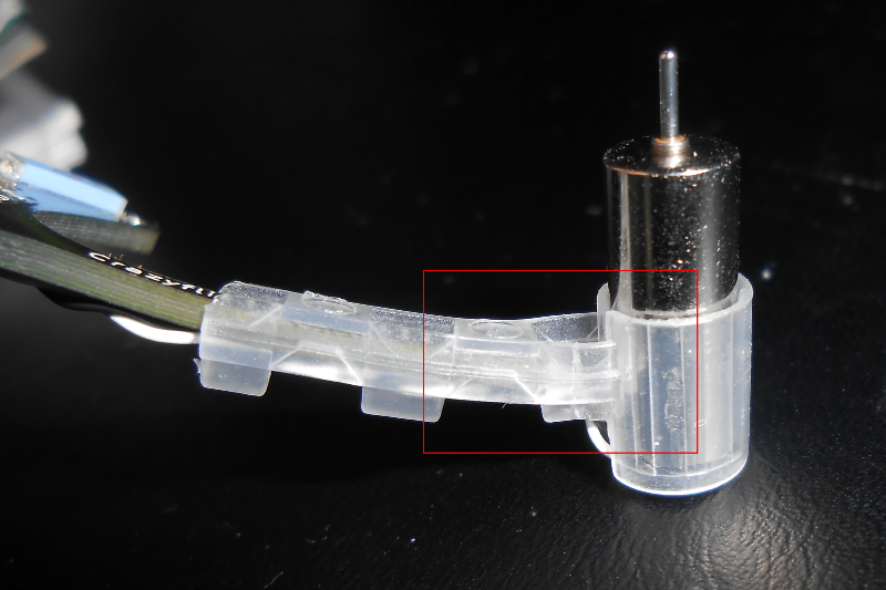

Re: [SOLVED] Broken one of the arms
I just quickly wanted to explain my theory. Still a lot of testing left to be done. The pictures should be pretty self explanatory but the idea is to make the motor mount the weak/flexible part by moving the motor mount out a bit.

Hmmm. Interesting idea Tobias. One could then wrap that arm end with the fishing line, you mentioned above, to strengthen the member so that the flex is not too soft. The combination of flexible motor mount and wrapped fishing line would add dampening from vibrations and absorb the shock on impacts.
