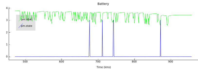

I send you a plot of battery values, showing 4 instabilities. I do not understand the 4 blue peaks.
I take out LED-ring. Flight looks more stable ?

1/some mechanical problem with one motor can occur during flight. I don't think is likely the case. I suppose motors are correct, with clean axis and no loss of power after crashes. This can be verified with a short run on the ground (aircraft "point fixe" in french). I use advanced flight mode with minimum thrust at 12%. Then test is clearer.
2/discontinuity in the battery electric power. This seems to be confirmed by my plot in my last post. So there can be a sudden change in attitude, then rapid cruise in some random direction and crash if the wall is not to far (indoor case). I have no experience outdoor. The question is that this failure occurs even when the battery is fully charged.
Thank you for your opinion.

My analysis:
