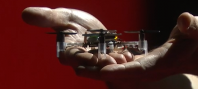

If there is some type of sensors embedded on the device, its difficult to see anything in the video, I have taken a still and attached this to see if you guys can spot anything?

Two of the publications contain references to "Ultra-wideband ranging radios", which sounds very similar to what Bitcraze is developing with the LPS.
Maybe the Bitcraze team can ask the ETH Zürich researchers for some insights.

They seems to be using the same radio module as we are, the DWM1000. If so, it is really nice to see what the module and the UWB system is capable of.
I got the papers, now let see what can be implemented (these things tend to be full of math ...
