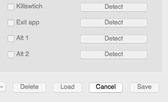

I'd like to map this as well. However, I don't see a alt 1 or an alternative 2 button in my input screen.
chad
Posts: 555
Location: New York, USA
Re: Mapping keys to parameters
Post by chad »
Psichosix wrote:I'd like to map this as well. However, I don't see a alt 1 or an alternative 2 button in my input screen.
Are you using the dev-inputdev branch? The mappings are not on the master yet.
The alt buttons should be on the lower-right of the configure mappings window.
alt mappings
alt mappings
